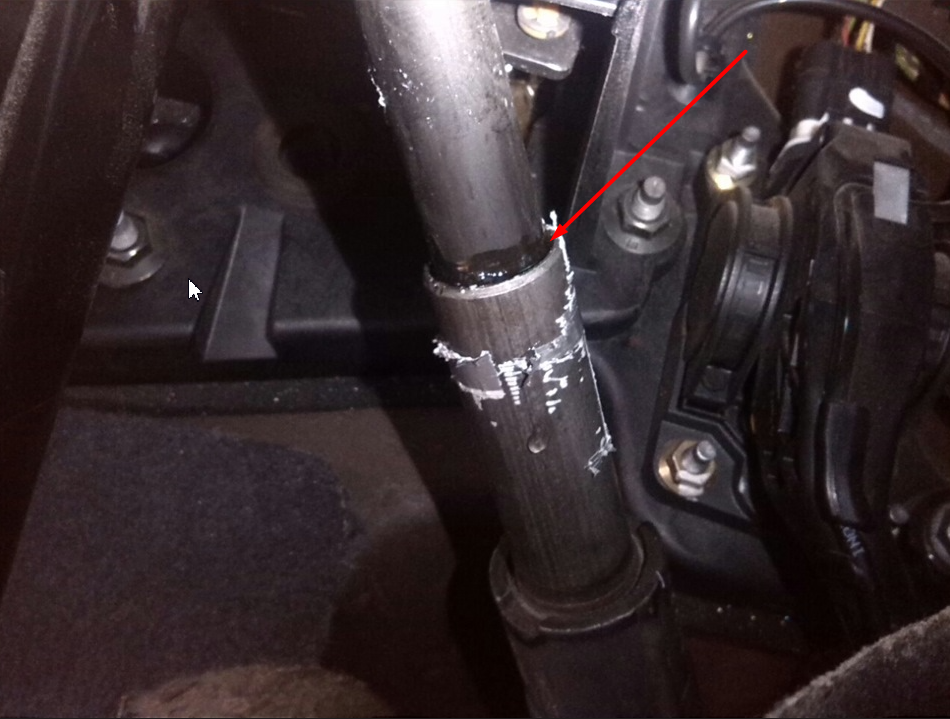

Earlier I was asking about the clanking noise from the steering. Maybe somebody will need a solution, so I'll describe it here.
It's not about the noise from the rack, underneath the car. It's about the clanking noise from the interior, somewhere above the pedals. It sounds louder when driving on a gravel road or something similar, with small imperfections.
Anyway, the steering rack also can be rebuilt if you know how to do it. But it's a different noise.
What I was asking is about the noise that comes from this part:
It can be heard louder when the wheel is adjusted to be as close as possible to the driver and can change the loudness when you push the steering wheel further.
As you can see there are 2 metal tubes with different diameters.
They are made to make the installation easier, they do not affect the steering wheel adjustment or the safety.
Initially what can be done to be sure this is the issue, just insert something there, between the tubes, drive, and see if the noise is gone.
What can be done, to get rid of that clanking noise on bad roads ( solutions I found online)
1. can adjust the position, in my case it helped, I pushed the wheel from the extremely close to the driver position.
2. make some longitudinal cuts, and tighten with some straps
3. I sow that someone welded them (check closer my first image above)
4. on the thinner tube put a rubber tube/pipe so that both tubes have the same diameter. Put a long metal tube with the inner diameter=outer diameter of the thicker tube, so it covers a few cm of both tubes and tightens them with a few straps.
I just hammered a nail in the gap between the two tubes and that tightened the gap and made them tight.

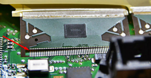

I mentioned that I have a few lines missing on my display.
It's the monochrome one.
Took it off, and found that the issues could be with these:
1. the contacts must be welded back carefully
2. these contacts must be cleaned from the old glue and glued back
Aneesh84, that's another workable solution.
I couldn't figure out how to take off quickly the knee airbag.
What I heard from people that used this one, is that over time the nails can come off their place, so they just zipped them if they are long enough or put a zip around the tube above those nails.
Another super- quick solution that I just did, just put some super-glue in the gap between two tubes over the night, made a dumping isolation between them.
Super efficient, all noises are gone, will see for how long :)

OlegR wrote: 03 Apr 2023, 06:47
Yes alternatively a hose clamp over the nails should also keep it secure and tight.
You can try them if your glue wears off!
