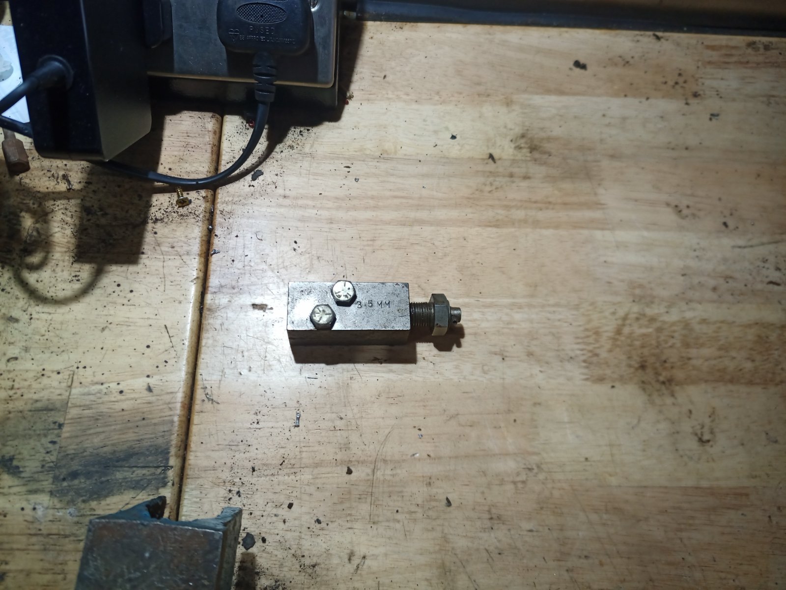

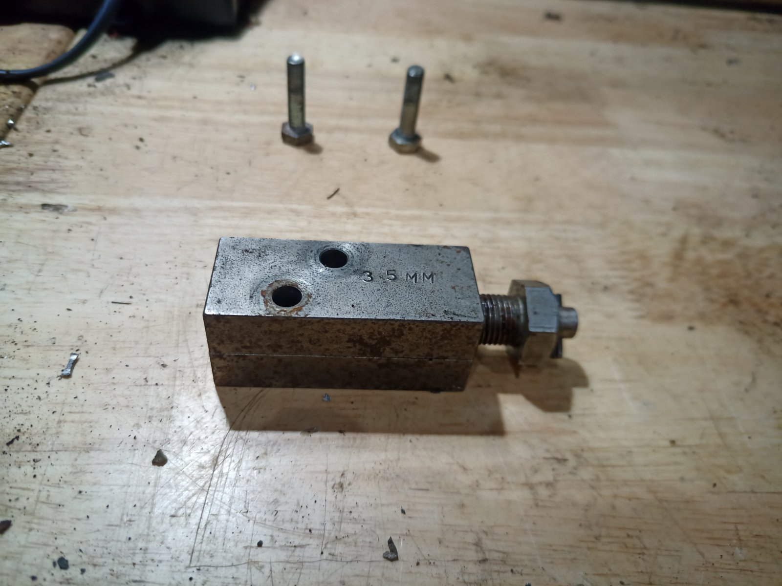

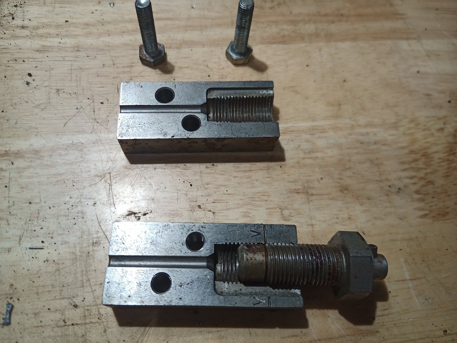

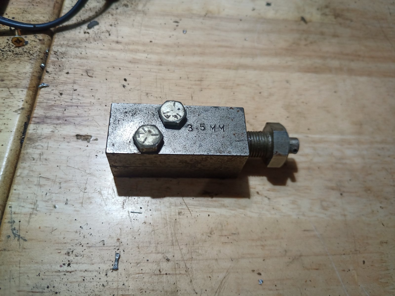

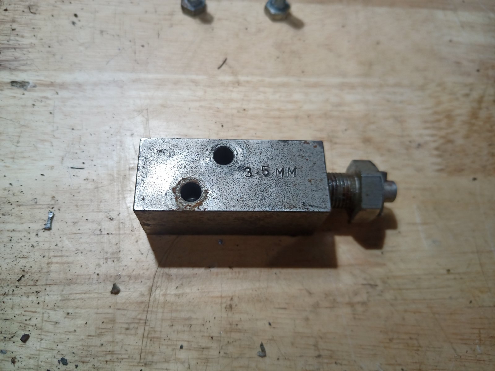

Given the urgency of your timeline, I sneaked down to the workshop to grab pictures ASAP. Because I was in civies (Clean Clothes) I wasn't for faffing about with emery cloth and WD40 to clean the tool up for it's photoshoot, and similarly you'll have to excuse the manky state of the workbench in these pics. However, here's a few pics of the Pleiades in situ 3.5mm pipe flaring tool I have available for loan with deposit, minus postage charges.
As you can see it's a toaty wee thing, around the size of a normal set of dies for a conventional vice mounted flare tool.

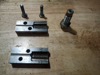

Zooming in a bit you can see it's a 5 part assembly, 2x locking bolts, 2x die forming blocks, 1x mandrel screw.

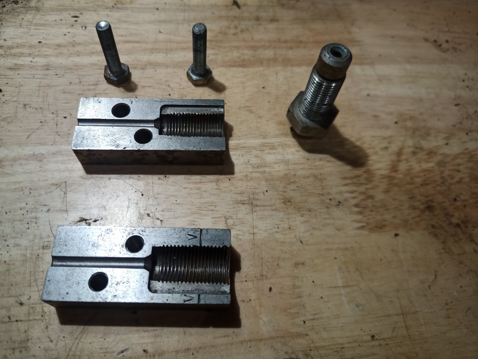

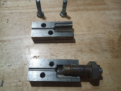

Opening it up by undoing the 2x locking screws you can see it clearly.
Sorry, I couldn't find any citroen 3.5mm cuni to mock this up, but you'd need to buy a coil of this from Euro Car Care or Pleiades anyways. The operation starts by slotting the pipe from the thin groove on the left of the picture up to the line with the V, hook the hollow section of the mandrel over the pipe:
Assemble the second die block over the other gubbins:

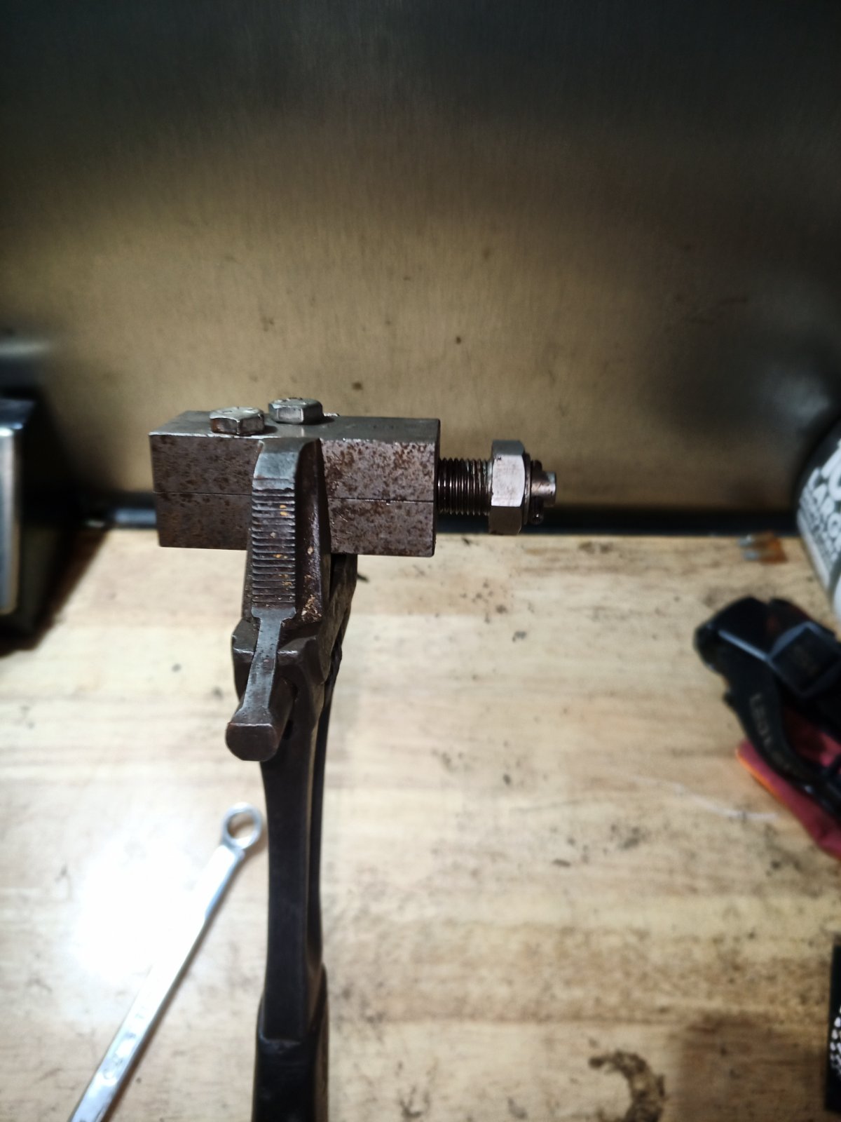

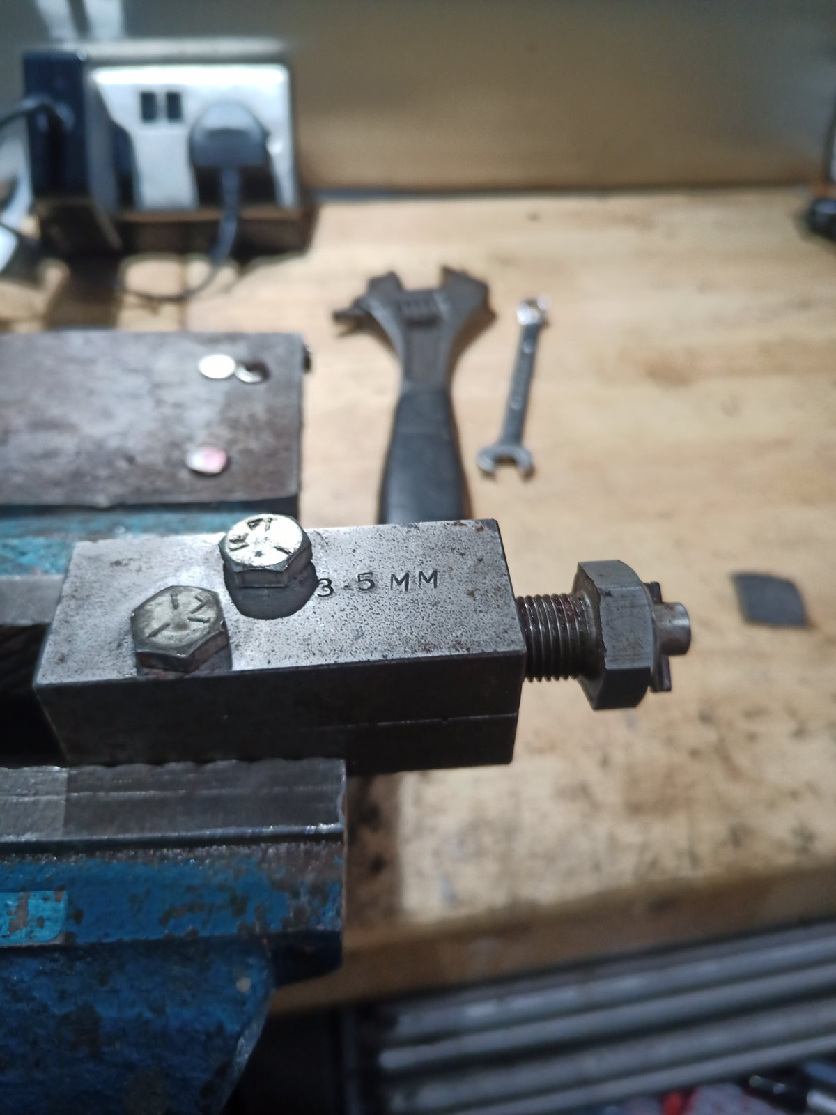

Run in the locking screws; and at this point I put it in a vice to show it can be used in the vice or on the vehicle:

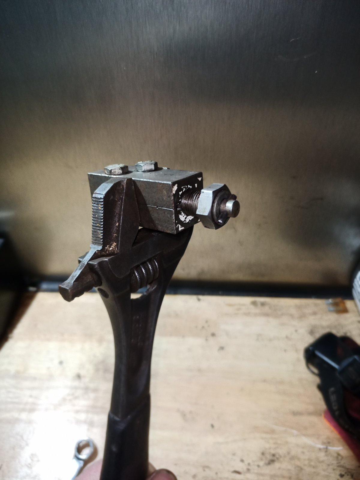

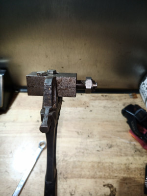

Or if being done on the vehicle, you can put an inch spanner (slightly bigger than 25mm, smaller than 26mm), rather than dig out my imperial stuff, I've just used a shifter in these pictures
I forgot to measure the spanner size of the mandrel hex, but it'll be in the region of 19/22mm (3/4" / 7/8"), wind in the mandrel screw till it bottoms out, undo the locking screws, remove the top die block, extricate pipe end from mandrel screw, slide on rubber, poke pipe in port, run up pipe nut (Pleiades do nice stainless ones :-) )route your pipe to the other end, rinse repeat to flare the second end.
I've gone into "teach your granny to sook eggs" levels of details in the above, but the process is no different from a conventional brake pipe on-vehicle flaring tool, just a special tubing and differently shaped dies/mandrel. The Locking screws are Grade 5 1/4" UNC and have a 7/16" AF or 11mm spanner size, so care must be taken not to lose or break them.

Re: Equipment loan pool
Unread post by Rhothgar »
Jay-Bruce wrote: 28 Mar 2023, 17:49 I forgot to measure the spanner size of the mandrel hex, but it'll be in the region of 19/22mm (3/4" / 7/8"), wind in the mandrel screw till it bottoms out, undo the locking screws, remove the top die block, extricate pipe end from mandrel screw, slide on rubber, poke pipe in port, run up pipe nut (Pleiades do nice stainless ones :-) )route your pipe to the other end, rinse repeat to flare the second end.
Great description. I have PM'd you.
So the mandrill is put over the pipe end whilst it is in the half of the die before the second half of the die is clamped over? Presumably this is to line up the 'V' line and the relieved line in the mandrill.
I read somewhere about your previous poor experiences with loaning tools. If you wish to specify a torque for the UNC bolts, that would be useful. I'm not your typical Neanderthal so don't necessarily go daft with torque up bolts but a specified torque would be ideal. I imagine it wouldn't require much nipping up to grab the pipe securely and prevent slippage.

Tool is easy enough to use. However, what would you recommended for deburring the end of such a small pipe diameter?
