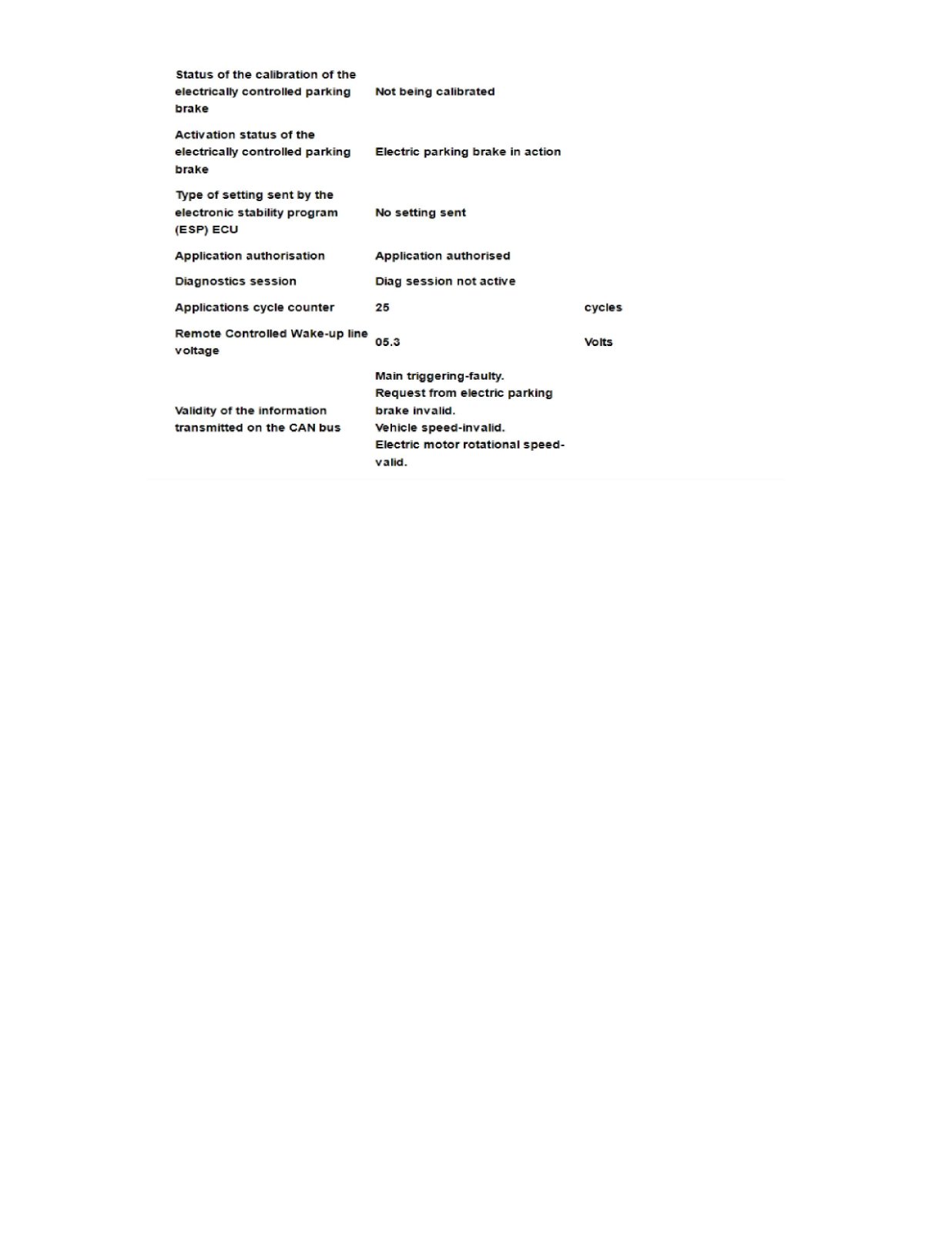

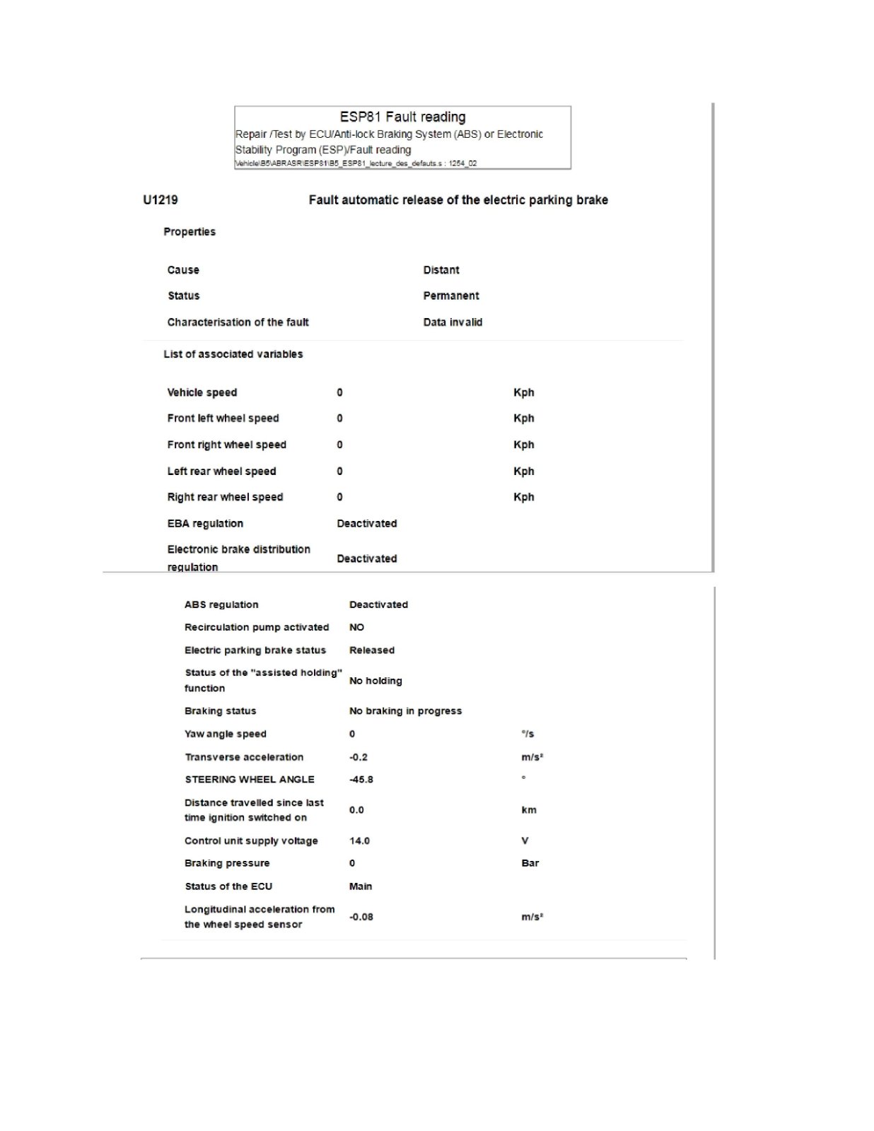

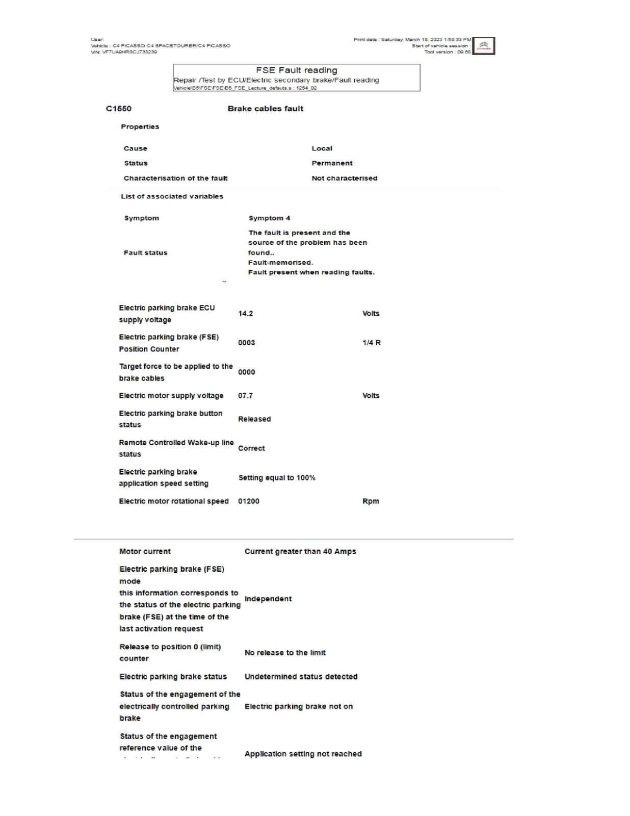

I did a fault reading using Diagbox and got codes C1550 and C1219 U1219.
VIN - VF7**************[VIN obfuscated, can be read by forum staff]
Please see the attached Daigbox error reading and please help with what needs to be done to resolve these issues.

Split this off into a separate topic as yours is a different system. It says cable fault, but not sure what that means, is one of them broken or not attached?

U1219 has no further detail: Communication with the Electric Handbrake ECU: Value received incorrect.
Fault Code: C1550
Description of Fault: Brake cable faults. Cables frozen or problem with calipers.
  • Cables broken or problem with fitting
  • Internal problem (engine, pinions, torque limiter)
  • Cables defective or incorrect calibration
Conditions for Fault to clear: Application and release of the electrically-controlled parking brake successful.
Downgrade Modes whilst Fault is active: Deactivation of automatic mode
The electrically-controlled parking brake completes the application taking place at reduced speed and only authorises release
Switching on of the warning lamp and/or warning message: *Warning lamp (see picture and reference below this table)
- "a" : lit
- "b" : On for 10 seconds after the request for application
- "c" : lit
Symptoms:
  • Illumination of LED/Error message
  • Electrically-controlled parking brake does not apply correctly
  • Electrically-controlled parking brake releases unexpectedly
Suspect Areas:
  • Electrically controlled handbrake cables (Primary or secondary)
  • Clip
  • Outer cable stop
  • Fixings
  • Calipers
  • Electric parking brake
