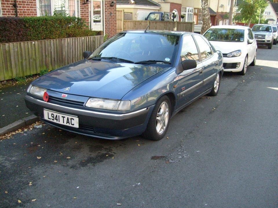

Papa found a pic of Xantia today!!
As you can see, I have her stylish alloy wheels. They were really too big for her anyway....
Love
Otterchops.

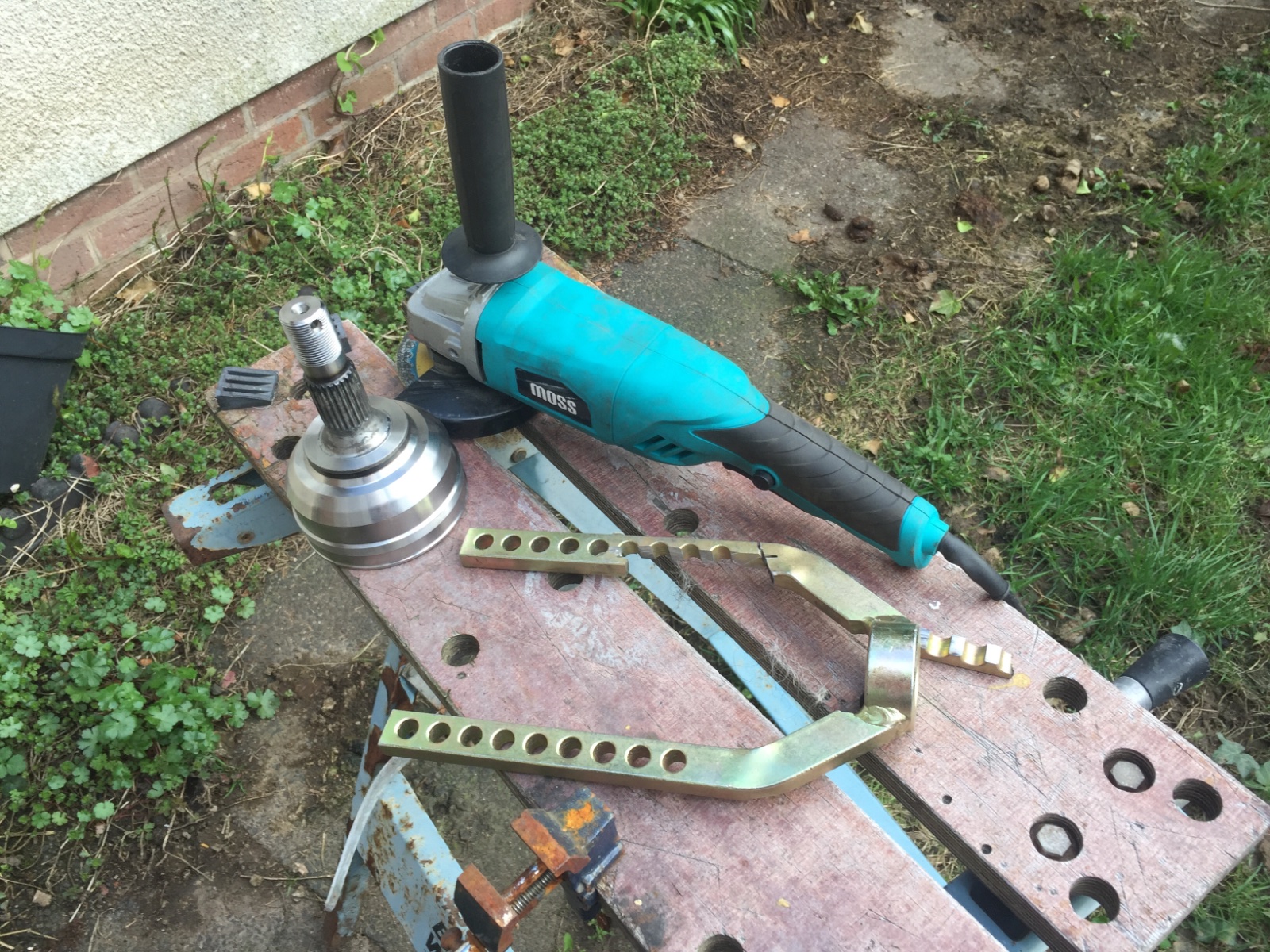

I have had fun today. Papa does look funny when he goes purple!!!
Today he tried to replace my offside CV joint. He'd bought one awhile ago and a special puller to change it. Then discovered my heavy duty CV joints were too big for it. Anyway, this afternoon he fired up his angle grinder and made loud ZZZZZIIIIIIINNNNNNGGGGGGG noises. This meant that his newly modded puller would fit but then I threw him a curve ball. Surely if you have enough space to get the old one off, you should be able to get the new one on, right?
Nope!!
This means that he needs to remove my driveshaft and do it properly!!!!
He has just ordered new driveshaft seals and new gearbox oil.
And his Wallet is attacking. Hear the screams!!!
You can see here how he has modded the puller and my nice new CV joint. Seems a shame to get it dirty.....

Ahh! I was wondering where an angel grinder came in to swap a CV boot and now I know
Good work on modding a tool to do the job

Hello, Unka Jim.
I,have VERY heavy duty CV joints to handle the massive power and torque from my exquisite engine!
This CV puller is clearly meant for use on lesser machines. Don't think anyone does them for a Citroen.

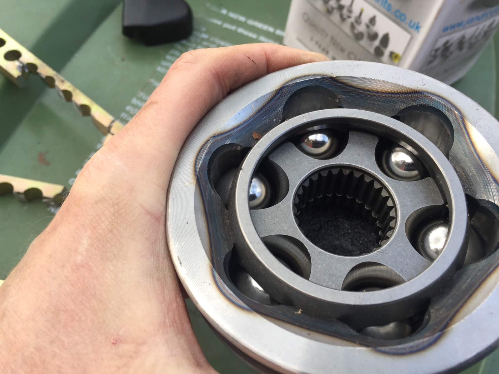

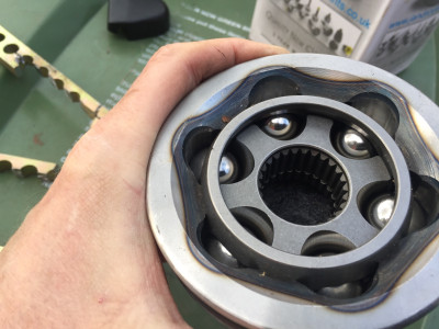

Papa has discovered why the new CV joints won't fit.
Do the bigger engined C5s have thicker drive shafts? If so, then my new, extra powerful brakes are not the 1st mod that has been carried out. Papa re greased the Old joint then fitted it with a new rubber boot. Then he discovered that he had not fitted my wishbones properly and that they sit too high. He used some pretty good words trying to reassemble my front suspension!!
After realising his error and deciding he needed his impact driver
to undo the bolt, he decided to check my slider pins and they were worse than he thought. Googats in fact. Grease had no effect so new ones have been ordered. He'll also need his impact gun to take off my caliper brackets. Heat had no effect!
