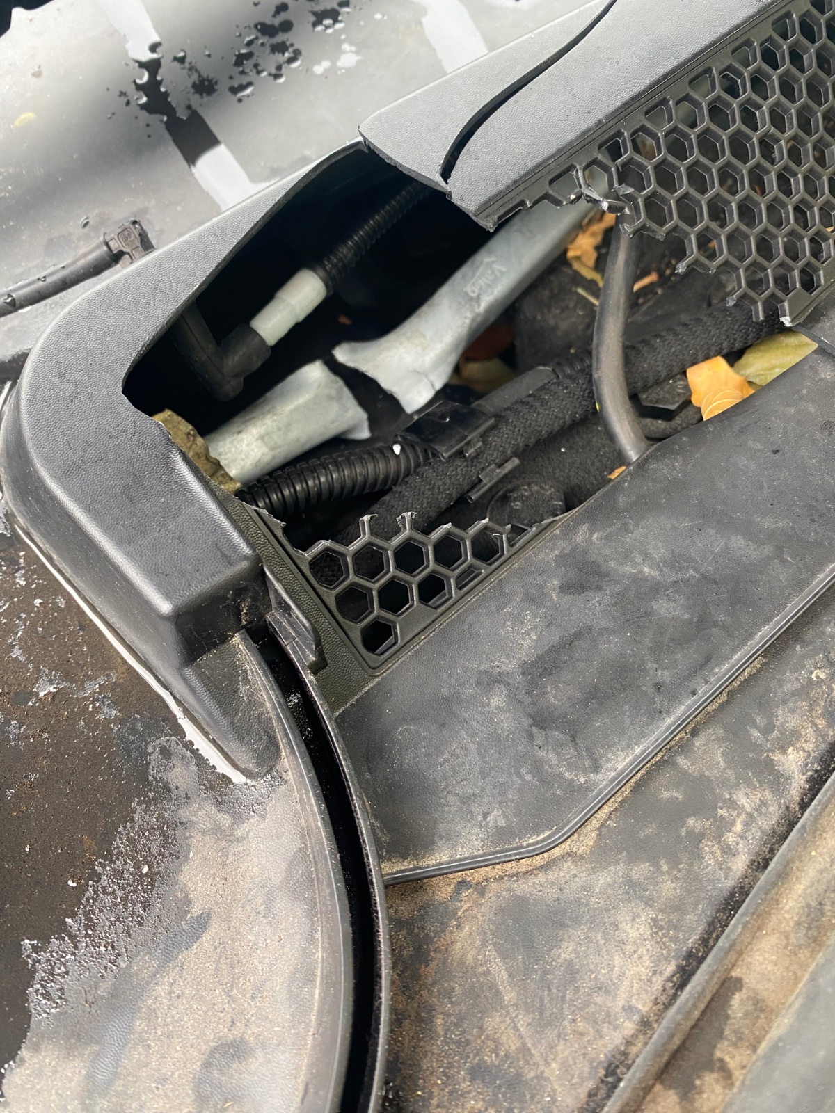

Hi all. The linkage in my front window wipers has broken. I’ve spoken to Peugeot parts and they say my only option is to buy the full wiper motor for £380; all I need is the linkage arm. Would anyone have any suggestions on how to get my hands on this part alone? Thanks in advance.

The motors are available separately to the arms. The arms can be bought separately too, so unless there is other damage I can't see, they're not being truthful.

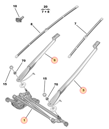

Ok, so first thing, please note that your vehicle is showing up with an outstanding after-sales campaign. I can't tell you what it is specifically, but give Peugeot a call and advise them of it with your VIN. They will be able to tell you what it is for, but regardless it will be free of charge.
Back to the matter:
As you can see from the diagram, you have the main motor assembly, plus the separate wiper arms:
(1) Front Window Wiper Motor, part: 9813395980, £430.02
(5) Wiper Blade Holder (left), part: 1636459780, £100.97
(6) Wiper Blade Holder (right), part: 1636459580, £100.97
All prices as of today inc. UK VAT direct from Peugeot.
