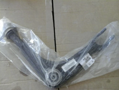

Yes, have a look at this picture which is a genuine wishbone from Citroen in the packing - if you look closely to the left of the photo, you can see the bush bracket I think you are after!
barryanto
Posts: 12
Joined: 06 Aug 2019, 12:12
Re: C5 X7 Lower Rear Bush Replace
Unread post by barryanto »
that's the part by the end of the year we will have it sorted lol
