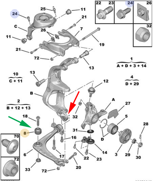

Re: C5 X7 Lower Rear Bush Replace
Ok, so if it's number 8 on the diagram that I've marked in Green, then it's part number: 3523AQ, (Front Triangle-Arm Wishbone Bush). These are £20.69 available direct from Citroen inc. VAT.
However, if it's the one marked by the red arrow, mine too recently went and Citroen do not supply the bush on its own, hence there is no part number. However, you can get the bush cheaply enough from motor factors.
Here is a link to one seller on the bay:
https://www.ebay.co.uk/itm/221738423630
I got mine from a motor factor supplier and my mechanics replaced it easily enough.

Unread post by barryanto »
no man it neither its number 16 by the look of the drawing citroen dont sell them either so it very hard to cross reference
The C5 X7 uses the same pivot and hub system whether Hydraulic or metallic sprung. There are different wishbone part numbers whether the steel or ally subframe and from different build dates. but as the bush is not available for this area separately from Citroen, I can't help you - but the wishbone for the left is part 3521S4 or 9663980680 for the right one.
The link I specified does list this part number in their listing - so you should be covered.
