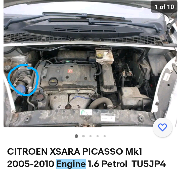

Not sure if the 1.6 petrol was the MA gearbox (which I'm not really familiar with) or the BE gearbox. But on a BE, mounting is on the top. It's normally well hidden with air filter housing, intake pipework and often battery and associated box helping to hide it. Normally all of these aren't that bad to remove.

Quick eBay engine bay photo
Sorry, looks accessible to me? (Obviously engine supported from above or below whilst taking mount off)
Sorry if I've wrong end of the stick! :)
