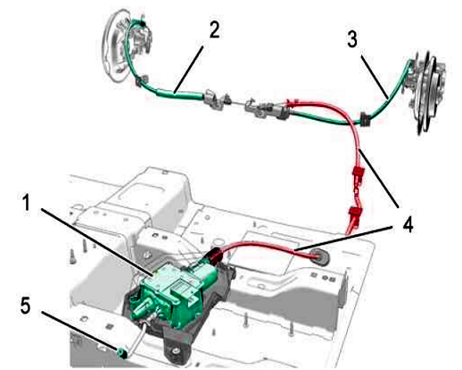

On this vehicle the Electronic Module Contracts or extends a Primary brake cable to the rear. From there it attaches to a mechanism that holds the rear left and right cables that act on the calipers.
So it is possible that either the left or right secondary cable (depending on the side you have the issue with) is worn or faulty. It could also be that the caliper itself is faulty of course.
Here you can see the mechanism and the 2 rear cables (2) & (3) shown.

From what I've discovered, it may be the ratchet in the caliper thats causing the problem. The cable you mention still releases and tensions fine when connected, but the caliper doesnt fully release the brake so the pads stay touching, effectively like the brake is on. I've added a temporary video link to let you see better. From your diagram it would be cable 2, the secondary that you are looking at in the video.

I can't be the the EPB motor - simply because it is applying the same power to both sides and the left side is working as it should.
I can't see it being the specific cable if it is attached correctly, so that leaves the caliper. It just seems to be sticking. If you are going to replace it I would avoid ECP in my personal experience and for many others here.
