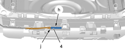

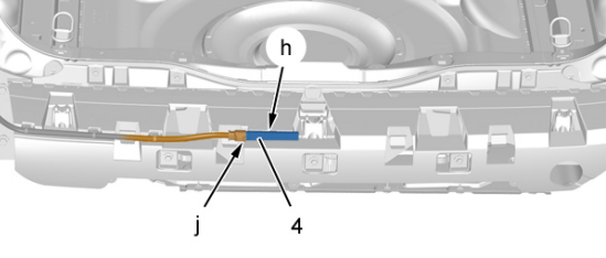

OK, so that confirms you have the later-built 2017 vehicle which has the 'hands full' system. This is the sensor that you wave your foot under the rear bumper and it opens the tailgate for you.
I don't have a lot of data on this later system I'm afraid, but I can tell you that it is linked into the hands free system overall that controls the access from the door handles and the aerials.
I think you have removed the item above which is actually the Hands Free Antenna for the Boot Zone.
This is linked into the ECU that controls the functions and works with the other modules and aerials, so it stands to reason that this may well have an impact on the operation of the vehicle. These systems are heavily integrated as you are seeing and can have an impact on other functions.
Now I'm not saying that this is the reason why it's not working, but it would help your troubleshooting if you had everything attached that is supposed to be there.

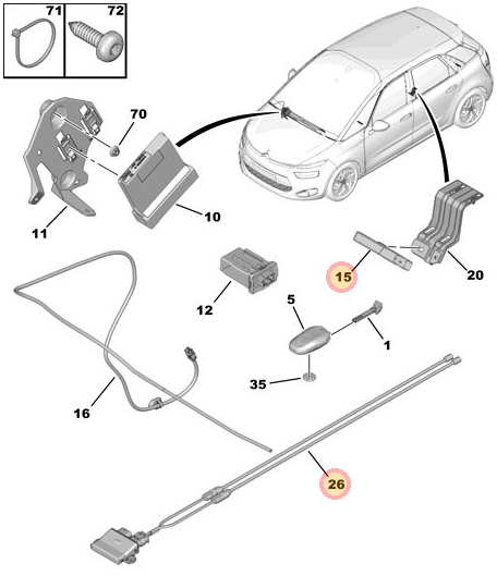

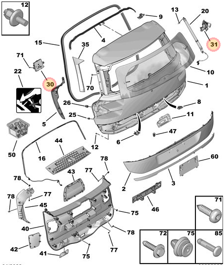

Ok, so these are the only components I can see - your vehicle won't have all of the components shown on the diagram. You have the later ranged vehicle, so they changed a lot of the components.
For example on the second diagram showing the hands free control unit, you don't have item (10) the old Hands Free ECU, item (12) or (16). The later system has only (15) and (26) along with the fob for example, so they likely have changed the aerials too. Whether there is now only the one in the central area item (15), that does the job of all of them I can't say. But the new ECU (26) is what you have.
Motorised Tailgate As far as the tailgate goes
(16) is the Anti Pinch Strip Sensor
(30) Tailgate Multiplexed Electronic Unit, part: 1682772280
(31) Tailgate Closing Module, part: 8731X3
Hands Full (15) KES Interior Aerial, part: 6060F4
(26) Hands Full Access ECU, part: 1643562380
If there are any specific parts you can identify on the diagram that you need confirming are present or require part numbers, let me know, as there's quite a few as you can see. We can only supply the parts diagrams as shown and not the technical disassembly documents, as we don't provide these unless a member has them personally.
