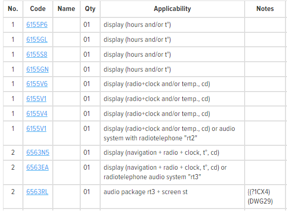

I think you were right with the display, today I checked what it is in my car, and the numbers show 6155v6, which is not compatible with rt2, I already ordered 6155v1 and I hope it will work. interestingly, when I unplugged the display, I turned on and off the ignition, then I plugged in the display, the phone came to life, and it worked until I turned it off, so it may actually be the display

Unfortunately, after replacing the display with one that should work, the phone still does not work
x 6961
Re: Installation of radio RT2 phone function citroen c5mk1 2002. 3.0V
It all depends on the model and build date as the units changed.. Maybe your friend has a later or earlier display...

however, you were right, I put on a display from a friend's car and the phone works, I have already ordered a display with specific numbers, and it must be fine, thank you very much for your help and best regards
