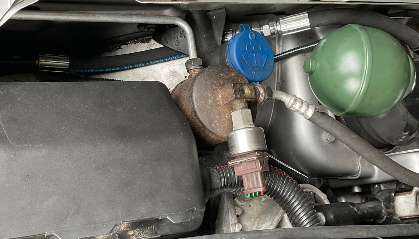

If you could find someone with a suitable crimping tool, the leak would probably be fixed by squeezing the sleeve a little more.

Just the rubber section..........re-use the metal parts.momag46 wrote: 26 Jan 2023, 09:15 That’s one hell of a pipe Alasdair.
I’m assuming a joint can’t be put in. When you say “replace the rubber pipe”, do you mean with a steel or rubber section?

Can the joint be re crimped?

Is the rubber pipe just crimped in place?, if so can it be separated from the steel pipes?

The rubber to steel joints have crimped steel sleeves on the outside, these are cramped with a die that leaves them perfectly round so that the rubber is evenly pressed onto the inner barb.
The steel sleeve is originally welded onto the pipe itself, to replace the rubber, the sleeve must be cut open and cut off, without damaging the inner barb. The replacement crimped sleeve would not be welded to th pipe.

A specialist will have no problem remaking/fixing the rubber pipe section to the existing metal pipes.....as said, just make sure they get the metal sections in their original orientation to each other.......
As a side note: LHM is quite common in hydraulics (JCB etc) so compatible rubber is/has been available for many many years.

Barry Annells has been doing his stuff! He had the pipe work made up and fitted it yesterday and everything is working fine.
Barry is a bit concerned about one of the joints but because I found the leak when getting ready for an MOT and that has now run out so I can’t give it a run yet. So it’ll be an MOT first and then see how we go.
