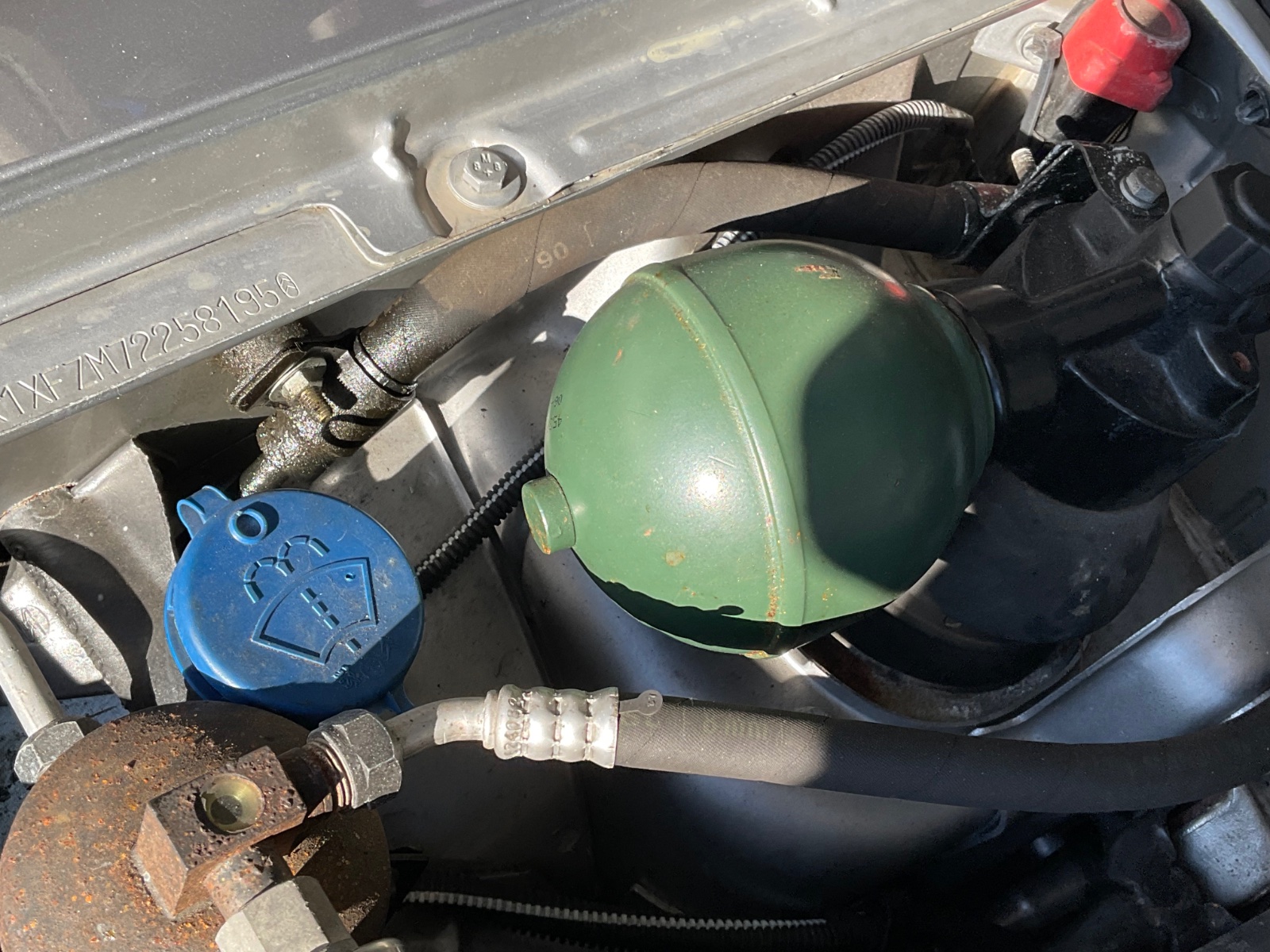

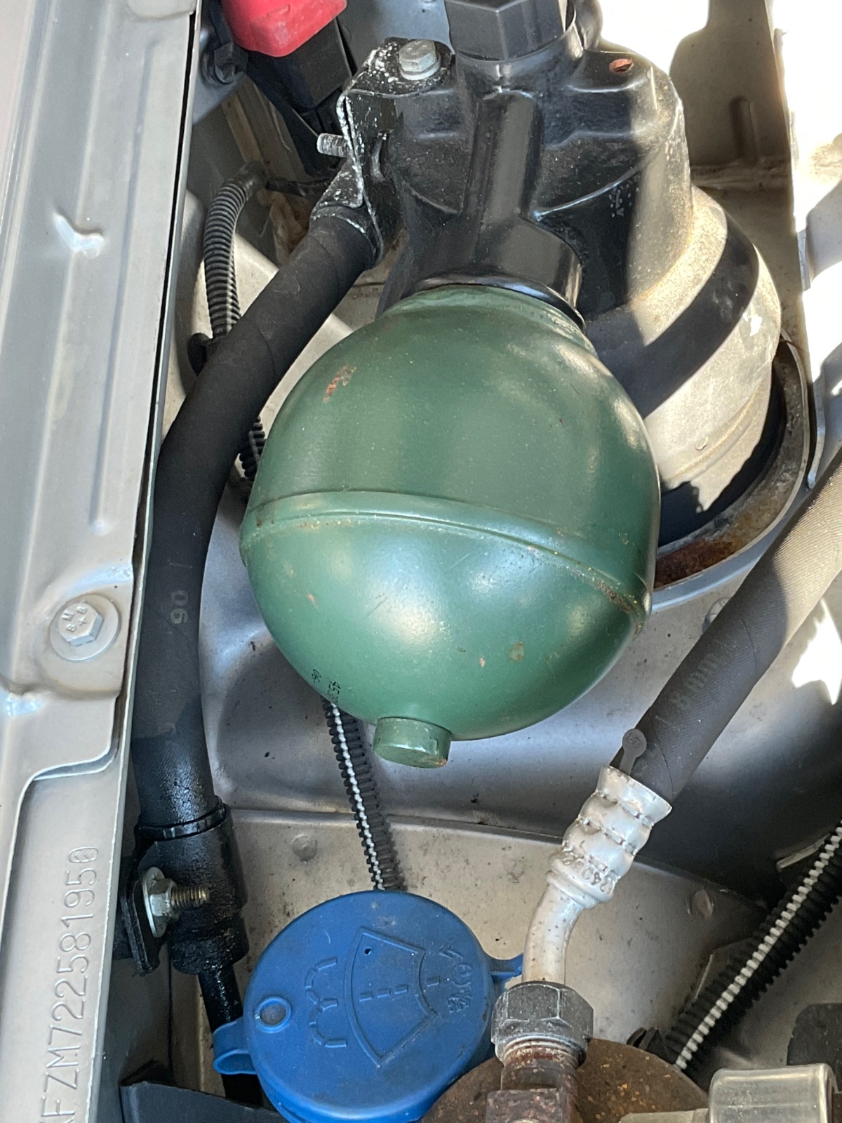

Hi everyone, I have a problem.
I have a leak at a pipe joint from the front suspension sphere. It is at a joint between a large dia rubber pipe and the normal pipe.
Is this something anyone has seen before?

All Xantia with Hydractive suspension have that pipe with the rubber section. I have not seen a failure at that point, but have had a similar crimped joint fail on my XM.
As the failure is rate, you should be able to find a good used replacement, or you may be able to find a hydraulic specialist who will replace the rubber section, but either way, the pipe would need to be removed from the car...

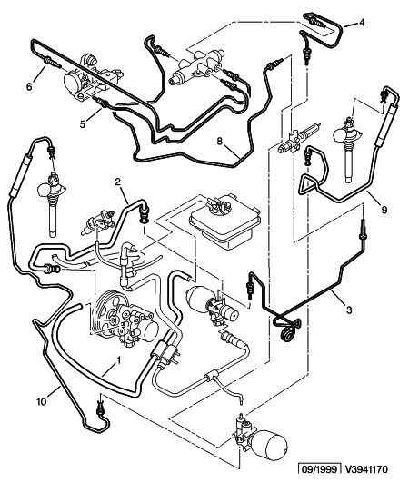

Just to help you visualise the pipe.
Ask Pleiades to remove it and give it to you (if they do not wish to fix it), take it to a good (local to you, there will be a good number in your area) agricultural hydraulic specialist and ask them to replace the rubber pipe reusing the original steel pipes, take it back to Pleiades for refitting.
(Note: make sure the refitted pipe is kept to the same orientation, like all Citroen pipes they should be a passive fit without tension)
