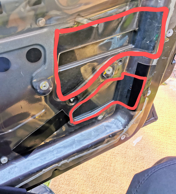

Re: Zel's Fleet Blog - BX, Jag XJ-S, Sinclair C5, Mercedes 208D & 230TE, AC Model 70.
Aside from the cursed thing that is the wing mirror adjuster that is an absolute pain to get together/apart it's really not that bad to get into.
Plenty of access to get the linkages onto/off the latch at least.
The door does now latch, but it needs a wicked strong slam. The one improvement is that the safety latch does now engage consistently rather than it just bouncing open 60% of the time.
I noted when I had it out that the latch plate still didn't move particularly smoothly even after I'd spent a while trying to clean it, so I reckon I just need to spend more time on that. The latch assembly is quite a closed design and there's no provision for it to be dismantled so trying to clean what's trapped between there and the body is a bit tricky.
Even if it had worked perfectly I was going to have to take the door apart again as in my haste to get things back together in the torrential sleet I forgot to plug in the central locking actuator. Oops.

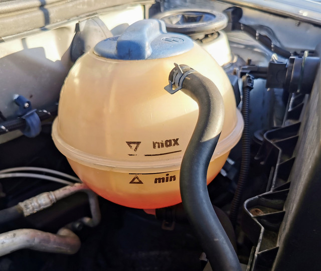

Well this is moderately concerning.
That coolant level hasn't moved a millimetre over the last year and 11K miles, however has dropped a couple of inches since it was checked last week. There's no immediate evidence of a leak, nor any obvious signs of head gasket failure. I'll need to do a more thorough inspection at the weekend. Sadly this is well into the realms of being modern enough to have plenty of plastic fittings and O-rings which are potential leak points. Plus of course the old favourite of the plastic tanked radiator. Which I'm sure with this having air conditioning would be a laugh to change.

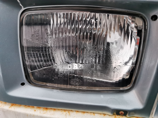

Not the only thing which will be needing attention at the weekend. Spotted this as I walked past the van today.
Winter and it's tendency to get water into all manner of places it shouldn't be can go away now please. These headlights are quite hard to find these days so I'll be taking that apart, drying it out and cleaning/replacing the lens to body seal as necessary. Really don't want the reflector getting tarnished. At least removing the headlight is a five minute job and dismantling it about the same.

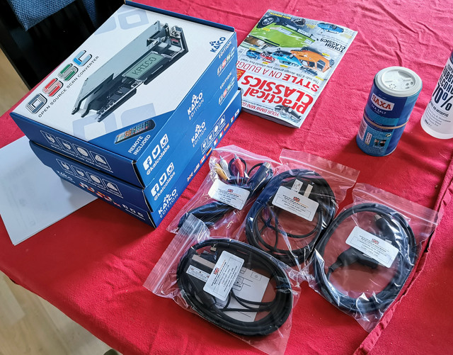

A fairly substantial stock take was one of the first steps here.
Firstly, a small pile of scan converters for the RGB compatible machines. These aren't cheap so they're reserved for the best of the bunch.
One of the big bonuses of having these on hand going forward is that they can handle both 15 and 31KHz line scan frequencies - so I *should* at long last be able to hook the Amiga up to a normal display and relegate the multi-sync CRT to storage for the time being. The requirement of a 15KHz capable display for a fair chunk of software both productivity and entertainment based has always been a big headache with that computer in terms of actual usability. It also does a nice job - I hooked up the Compaq PC next to my workstation which usually is just hooked up to the VGA port on one of my monitors (it runs Windows 3.11 in the usual 640*480 resolution) as an experiment, and the resulting display was absolutely pin sharp without any of the usual fuzz you usually see when running lower resolutions on LCD panels. So two will probably just wind up living attached to the back of the monitors on my workstation.
In addition to those three, there are another five cheaper converters which don't boast quite such fancy specs in terms of the signal conditioning and such, but have a couple of advantages...firstly they're £30 each rather than £150, and secondly while it's not actually mentioned anywhere in their specifications they can also handle composite/S-Video inputs. Which the OSSC can't, it's purely an RGB setup. This is useful as finding anything that does even a halfway respectable job of dealing with composite video is a bit tricky...there are the £5 ones on Amazon, which are basically useless for anything beyond actually proving a system is working. The image quality is absolutely appalling. The usual go-to choice in the retro computing community is a device called the RetroTink 2X - though there are two problems with that. Firstly they're $130 apiece, only available from the manufacturer directly in the USA...and they no longer ship to the UK following the changes to the customs rules a year or so back. They *do* ship to the UK...but only for their flagship product, and at $600 a shot (plus shipping, plus import duty, plus VAT - and I needed five) that wasn't happening. So I was very pleased when I completely at random discovered that these ones which are billed as RGB to HDMI only boxes did the job and promptly bought several more.
Most of the systems in question here have RGB video outputs anyway, the notable exceptions I needed to keep in mind being the Commodore 64 and Atari 800XL which are composite (or UHF) only. Oh, and the Spectrums - though those will be using dedicated displays which have native handling of composite video. Yes, the Spectrum does only output UHF out the box - but the input to the RF modulator is actually composite video, so getting composite video out of one involves lifting a single resistor and soldering in a single wire link. Suffice to say both of mine have had that modification done as the improvement in image quality is night and day even on a good period TV.

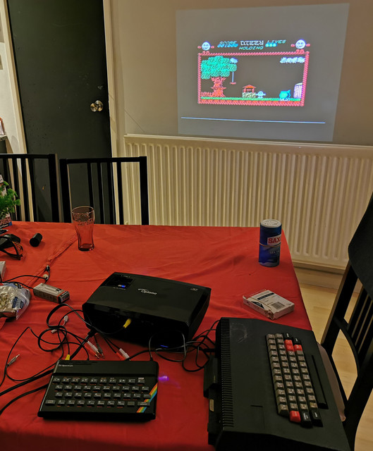

The Spectrums will both be running through projectors. The first of which shown on test here.
This little DLP one does a really good job (despite it costing me a whole £8 from a charity shop), the camera has absolutely murdered the image there - the colours are exactly the correct, deeply saturated hues you'd expect.

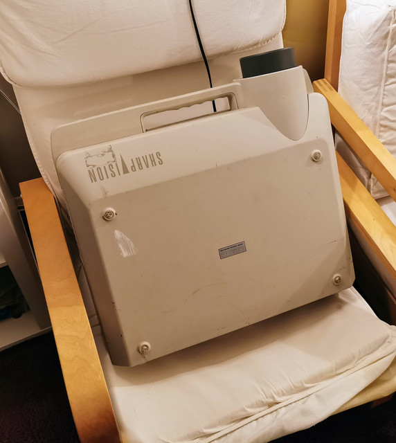

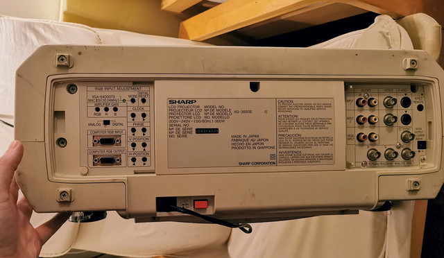

The other projector is this old beast.
This is a Sharp XG-3850, dating from 1993 and likely cost about the same as a new small family hatchback at the time.
For a start, it's a wonderful little technological time capsule in itself as projectors from this era are basically extinct. Secondly, using a £150 computer through a £5000+ display device just appeals to my sense of the absurd.

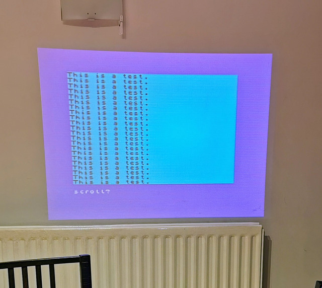

It actually handled text a lot better than I had expected, even when I deliberately chose awkward colours.
I was quite impressed with that, especially given that you're looking at a standard PAL composite image there being displayed via a trio of early 90s LCD panels with a native resolution of 640*480. It certainly does a lot better job of it than the other LCD projector I have from ~2005, which is coming along purely as a backup. The DLP one knocks them both out of the park, but you kind of expect that.

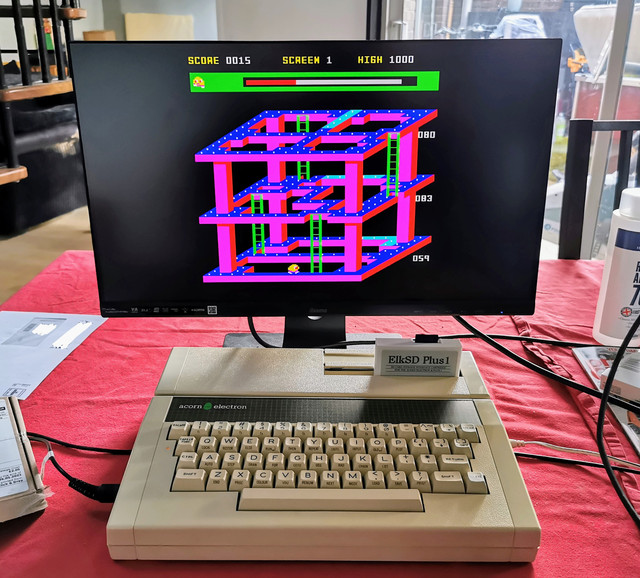

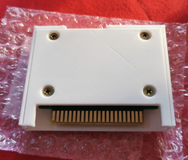

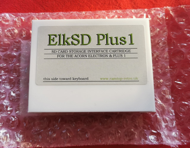

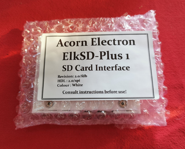

We did have a bit of success on the Acorn front though. This dropped through the letter box today. A real surprise as I only ordered it from the maker's eBay shop yesterday!
This is a cartridge based solution which takes an SD card, slotting into the Plus1 expansion unit on the back of the Electron.
Contrary to the headaches I'd had with the BBC, and the fact that I hadn't even tested the Electron at all since it's arrival up to this point, this worked straight out the box as expected.
Will need to load some additional software onto the SD card to ensure everyone's family favourites are on there, but that's otherwise ready to go.

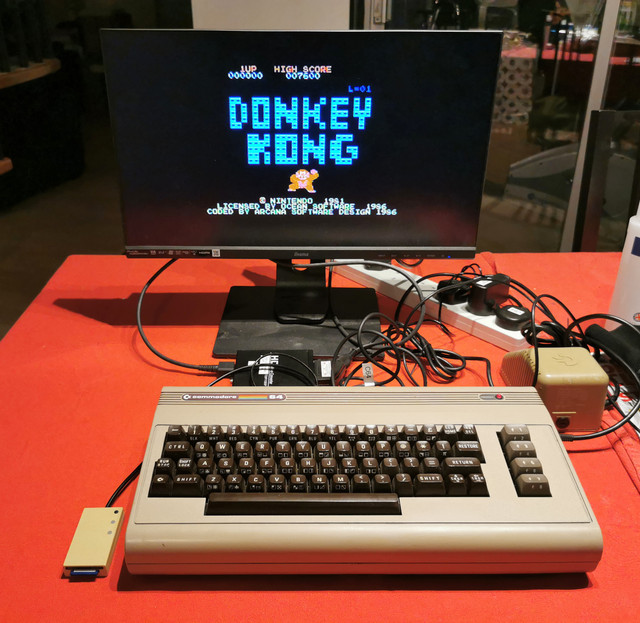

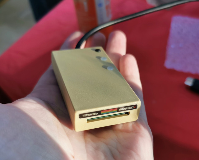

Barely an hour later the functionally similar device for the C64 arrived, the SD2IEC. This gets a definite mention for style, being made to look like a tiny replica of the 1541 disk drive.
As with the situation on the Electron this worked exactly as expected.
Though this really does highlight how horrifically slow the disk interface on the C64 was! Loading a game from the SD card on the Electron takes generally one or two seconds, whereas it's still often the best part of a minute on the C64. The difference in video quality is stark too with the C64 lacking an RGB output.

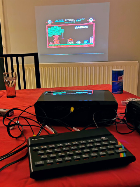

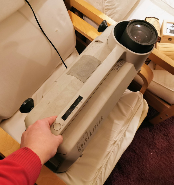

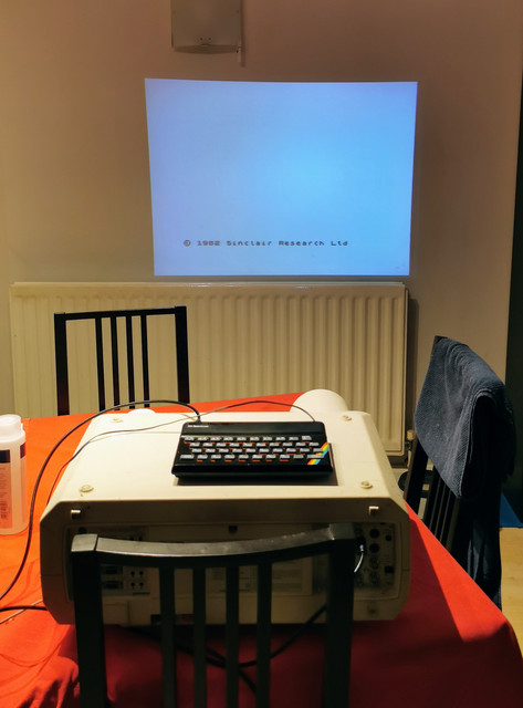

The Spectrum in the original case will be set up in a pretty prominent location in the room with the DLP projector with Jet Set Willy running. Expecting that to be a pretty good hook to get people interested. Haven't 100% decided what the other one (which isn't in an original case, having been upgraded to one with a real keyboard at some point) will be running, but one of the organisers has mentioned having fond memories of Dizzy, so that's high on the list.

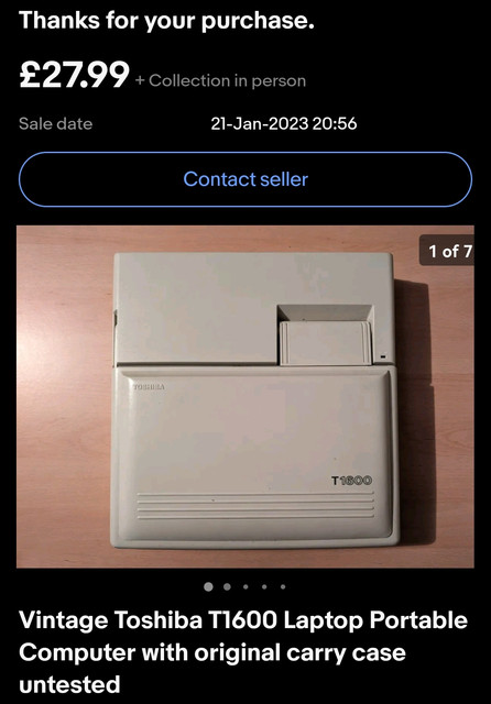

Get in there...
Of course the big question will be if someone has tried to power it up?
Guess I'll find out when I start tearing into the power supply PCB. Really hoping not as I'd really like to have one of these in working order. From the photos this looks to have been far better stored than the previous two if nothing else. Plus having the original case is always a big bonus.
