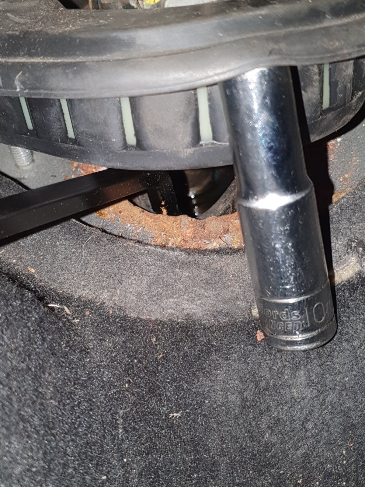

Disheartening newsaerodynamica wrote: 15 Jan 2023, 16:10 I have a leak! it's the steering. Usual place. I replaced the steering rack less than a year ago and it's leaking again. I want to cry now.
The LDS can be seen dripping from where the new pipe and the return pipe go into the pinion valve and I thought at first it might be the pipe connection needing looked at but had an idea to check through the rubber bung in the driver footwell and..
Looks like it's wet around the seal again. Not even one year.
Possibly also bad news for the effectiveness of the modification of fitting the CV boot around the area

I know manMattBLancs wrote: 15 Jan 2023, 21:27Disheartening newsaerodynamica wrote: 15 Jan 2023, 16:10 I have a leak! it's the steering. Usual place. I replaced the steering rack less than a year ago and it's leaking again. I want to cry now.
Possibly also bad news for the effectiveness of the modification of fitting the CV boot around the area![]()
Maybe disregard what I said about the rubber cv boot covering it all being ineffective. Correlation does not always equal causation!
I might simply be unlucky with the quality of the refurbished steering rack
