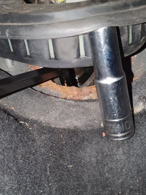

I have a leak! it's the steering. Usual place. I replaced the steering rack less than a year ago and it's leaking again. I want to cry now.
The LDS can be seen dripping from where the new pipe and the return pipe go into the pinion valve and I thought at first it might be the pipe connection needing looked at but had an idea to check through the rubber bung in the driver footwell and..
Looks like it's wet around the seal again. Not even one year.
Possibly also bad news for the effectiveness of the modification of fitting the CV boot around the area

Was it a brand new rack fitted or a recon? If recon, where from?

It's a recon rack. I'm not sure where from because the garage fitted it - there was a whole story about the poor service from the garage I was kind of hoping not to reopen..
Basically I supplied a recon rack from Glasgow Power steering but the garage fitting it managed to wreck it by tightening the mounting studs when they were not fully located and cracked the casting.... they admitted their error and supplied a recon rack that is now leaking.

Re: C5 X7 steering leaking AGAIN
Makes you wonder whether the rack was actually a recon and not just a S/H one.
Well, it 'looked' reconditioned.. in that it had new gaiters and seals etc and was painted. I don't know the supplier though. I'm concerned as to how/ where to actually source another one.Paul-R wrote: 15 Jan 2023, 17:00 Makes you wonder whether the rack was actually a recon and not just a S/H one.
