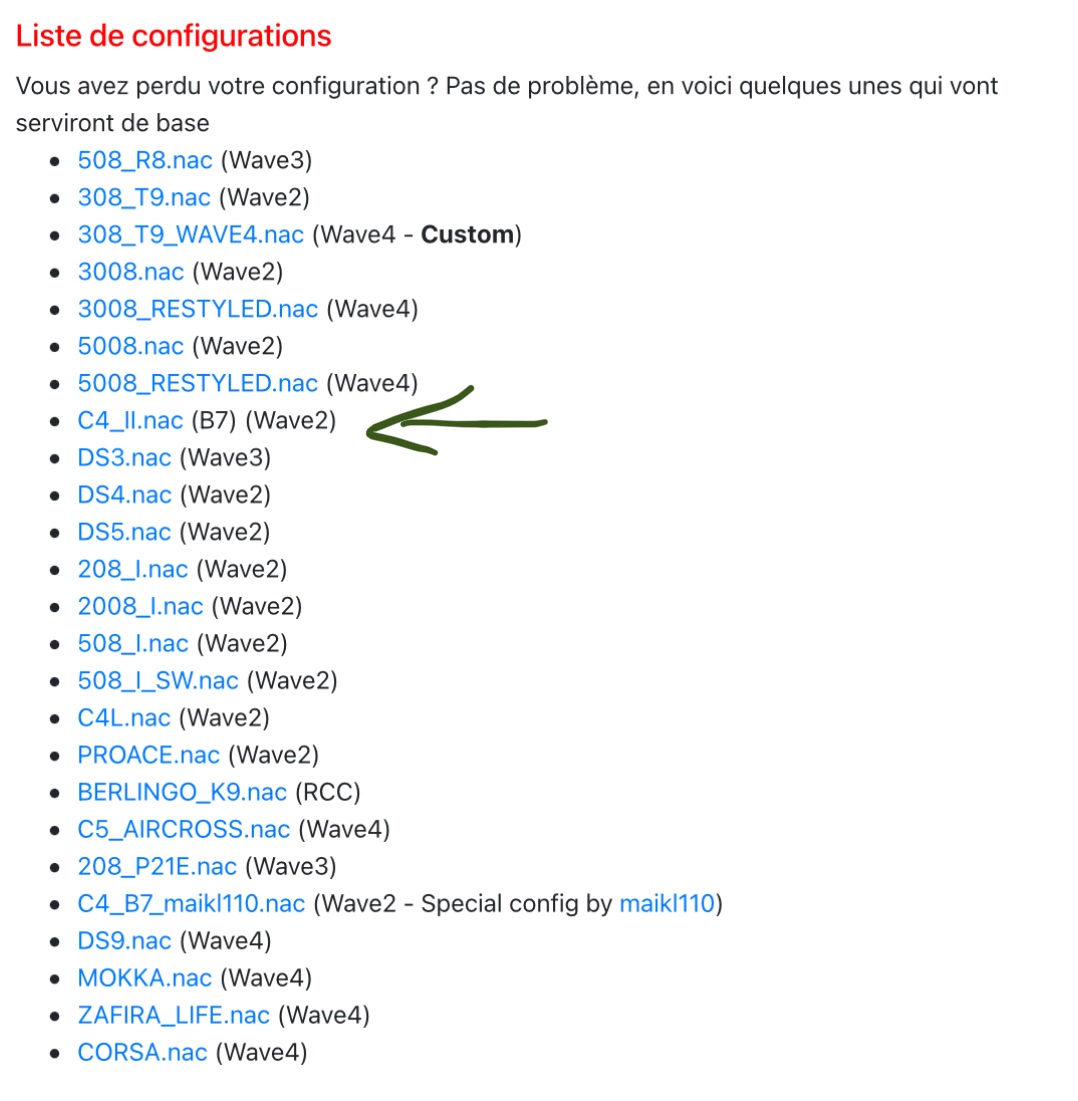

Hello, is this tutorial valid on a 2014 C4 B7.
thank you for your reply
MacSlavko
Posts: 132
Joined: 17 Aug 2017, 23:39
x 32
Re: RT6 to NAC (Connected NAV) Upgrade
Unread post by MacSlavko »
Yes. You can upgrade your infotainment system with NAC Wave2. The seller needs to telecode the new head unit for your car. There’s the configuration file for that on GitHub, so it’s all doable…
