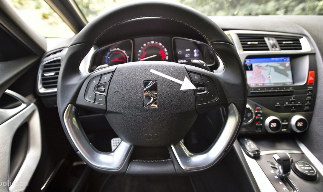

Any chances that forward/previous (songs/stations) buttons on a steering wheel will be working after the upgrade? This is very convenient now and when I am thinking of upgrade and realize that I need to touch the screen to skip the song... it's quite annoying. Any help? DS5 2015 (with the knob which also will be useless)
MacSlavko
Posts: 101
Joined: 17 Aug 2017, 23:39
Location: Croatia
My Cars: DS5 2.0 BlueHDi
x 21
Re: RT6 to NAC (Connected NAV) Upgrade
Post by MacSlavko »
If you can skip or replay a song by scrolling the small wheel on the right side of the steering wheel now with RT6, then it should work normally after the upgrade to NAC as well.
I haven't seen or heard that it wouldn't...
Definitelly works fine with my NAC as it did with factory SMAG+IV2 that I originally had.
