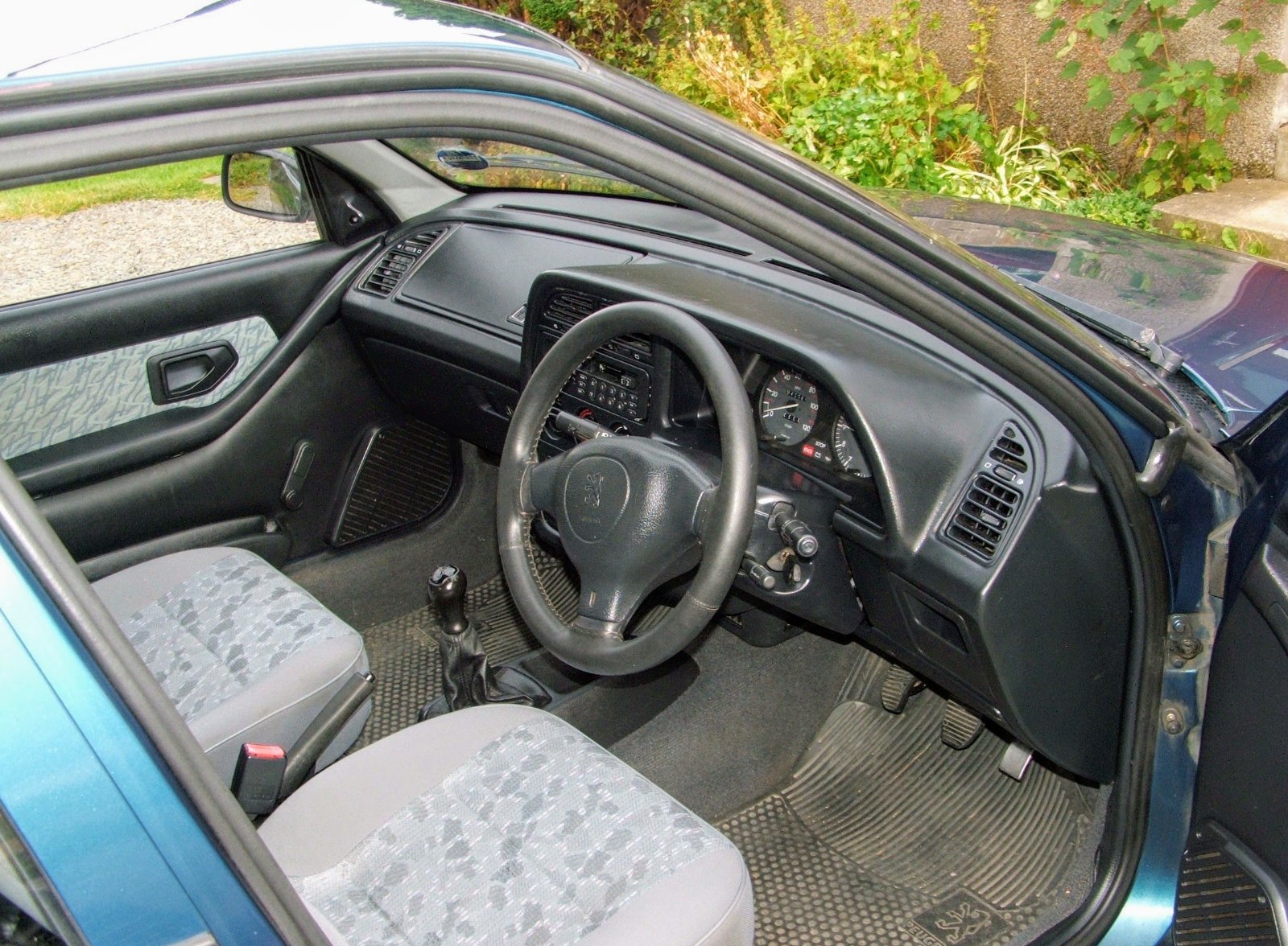

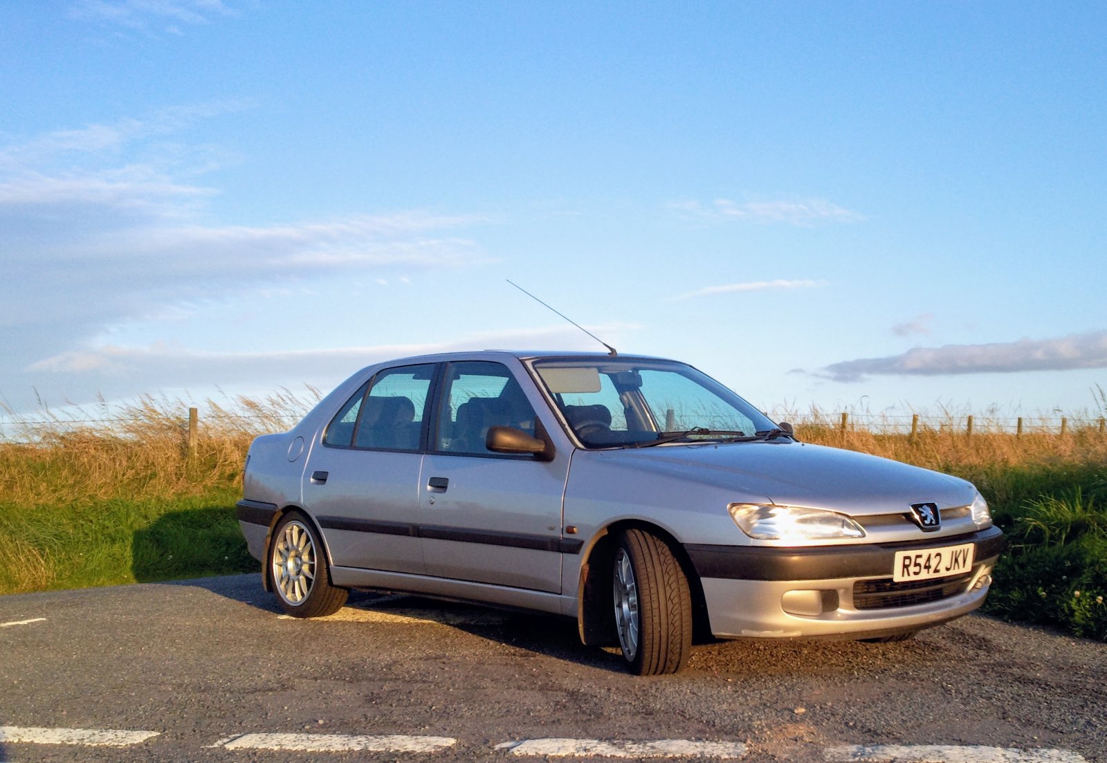

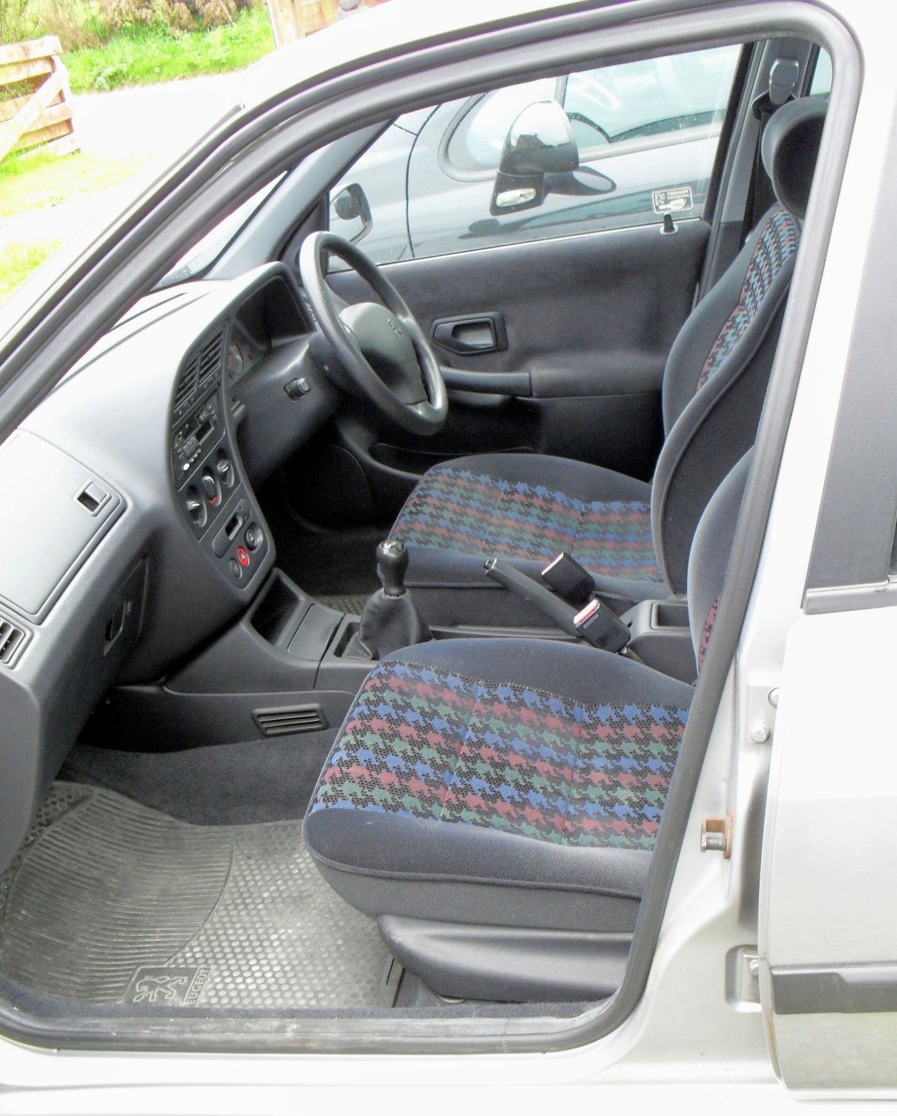

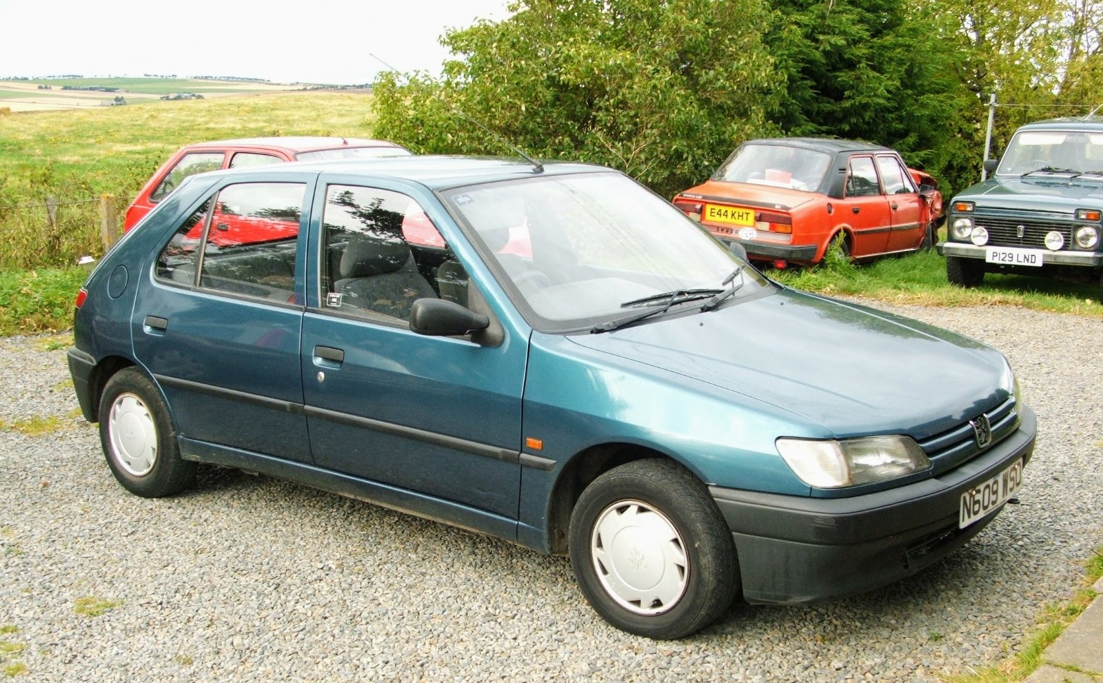

Interesting to follow this. 306s are cracking cars, have very fond memories of the two I've had. Especially the last one which was a really tidy four door 1.6 petrol car.
Was a great driving motor and definitely ticked that box of being "the only car you'll ever need." Plenty of room, comfortable, brisk enough, and a great drive on a nice country road.
The first one was a very basic spec n/a diesel which was bought in a pinch, but still drove well.
While somewhat agricultural (especially when the exhaust downpipe cracked), the performance always felt up to the job. Not quick, but it got the job done.
No idea what I got economy wise as the speedometer and odometer were dead, but pretty sure it was pretty decent.

Love those! The saloon especially, quite unusual. And yes, when the exhaust was broken on mine it was rather deafening!Zelandeth wrote: 06 Jan 2023, 00:34 Interesting to follow this. 306s are cracking cars, have very fond memories of the two I've had. Especially the last one which was a really tidy four door 1.6 petrol car.
