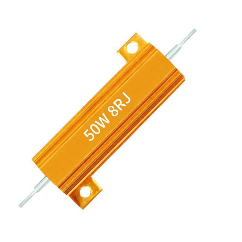

I have LED reversing lights on the Civic that are very bright, came with 50W ally resistors but they weren't needed. Probably would in a canbus system though.

If the blinkers blink fast add a resistor. It happens on bikes with the mini indicators that have a lower wattage

no nothing to with heat, although you may need to place the resistor somewhere aerated. It's because LED's use far less power.
