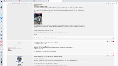

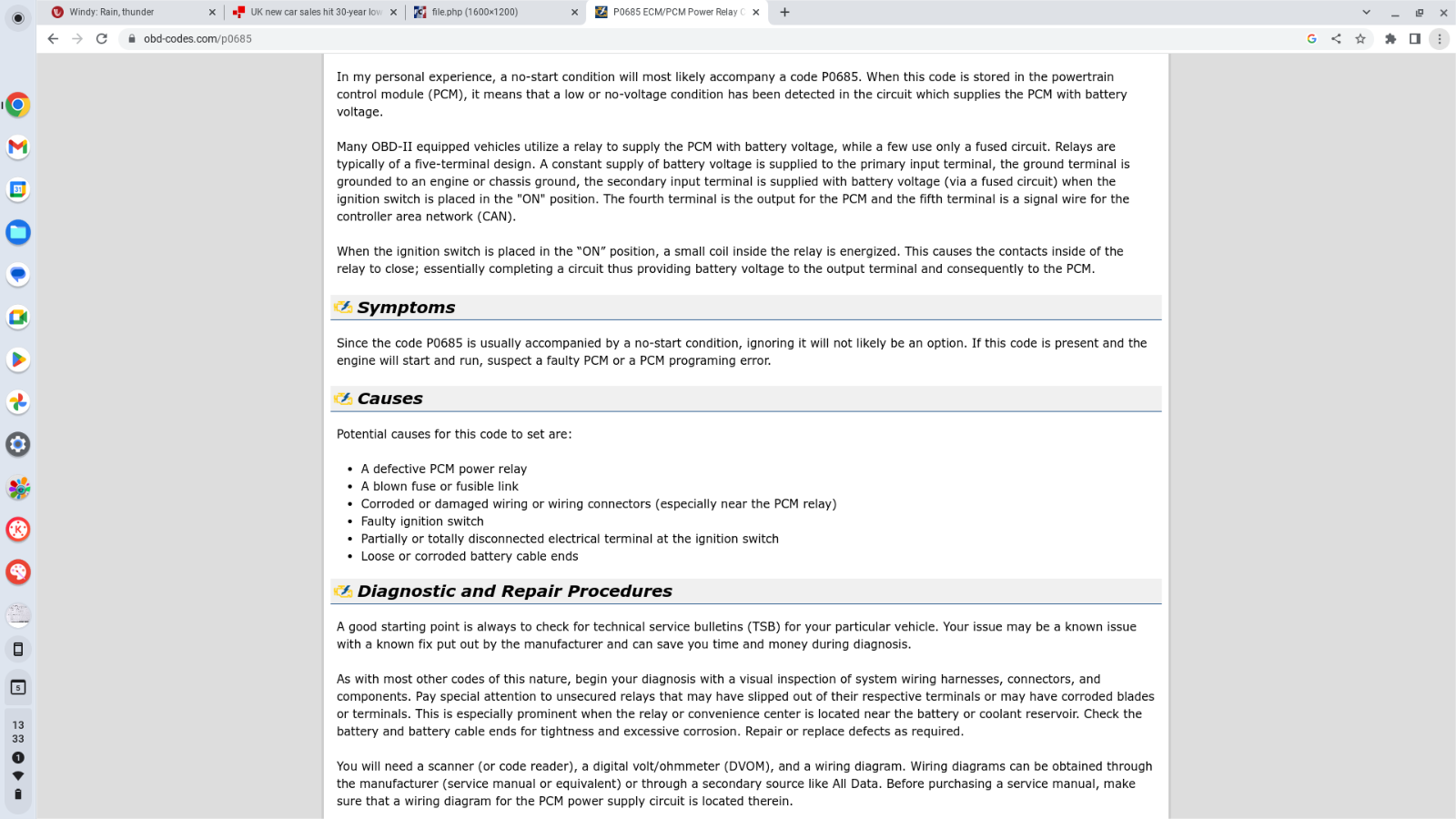

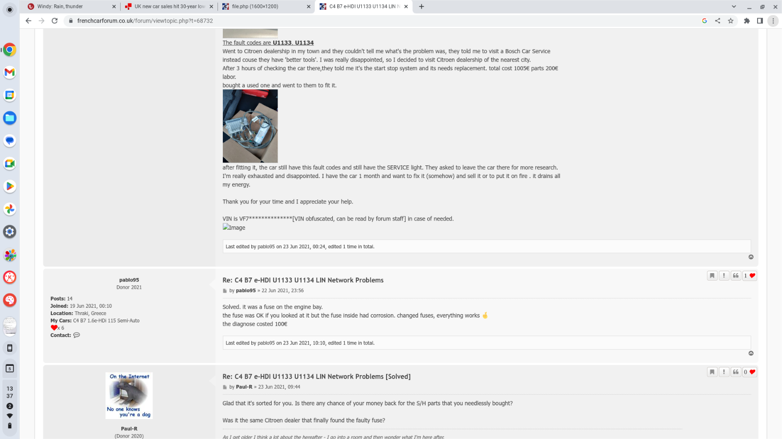

I found this article in FCF
and this generic OBD advice
Does anyone have a suggestion of where to start for MelC4. I have said Wiring/Alternator and he has visually examined the harness/boxes.
