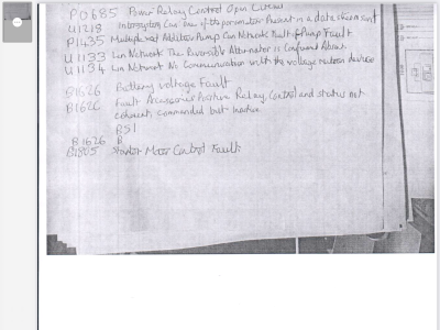

MelC4 has this list of faults.

Does anyone have a suggestion of where to start for MelC4. I have said Wiring/Alternator and he has visually examined the harness/boxes.
