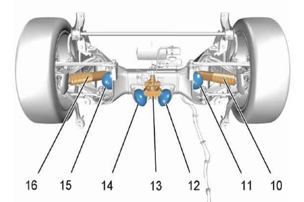

7 spheres? One at each corner, 1 centre front. Where are the other 2? Inner rear?
2015 C5 Limited Edition (2.2 HDI) 150 kW 450Nm (Racechip S 179kW 528Nm)
- x 6950
Re: C5 X7 harsh front suspension
The other 2 are at the rear centre. They are housed under a protective shield and connected to the rear hydraulic block.
(10) Rear suspension cylinder (right).
(11) Rear suspension sphere (right).
(12) Rear stiffener regulator accumulator (right).
(13) Rear firmness regulator.
(14) Rear stiffener regulator accumulator (left).
(15) Rear suspension sphere (left).
(16) Rear suspension cylinder (left).

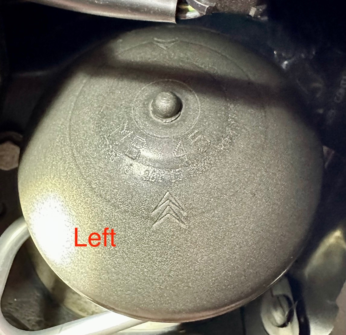

I only replaced the front left sphere and that was 3 years ago, so I don't have records of it. It has the Citroen chevrons embossed on it (but I'm sure that doesn't mean anything) and some numbers, but they're not as distinct as on the right one (presumably an original). Virtually unreadable, but I think I could decipher the ones on the right one. (pics attached)
Is there a good source for them in the UK? I'm coming over next (northern) summer so could get any I need then.
Not sure if I'm paid up enough to get part numbers (and How To's), but could I get the front corner and centre sphere part numbers and a How To for changing the centre sphere? Thanks.

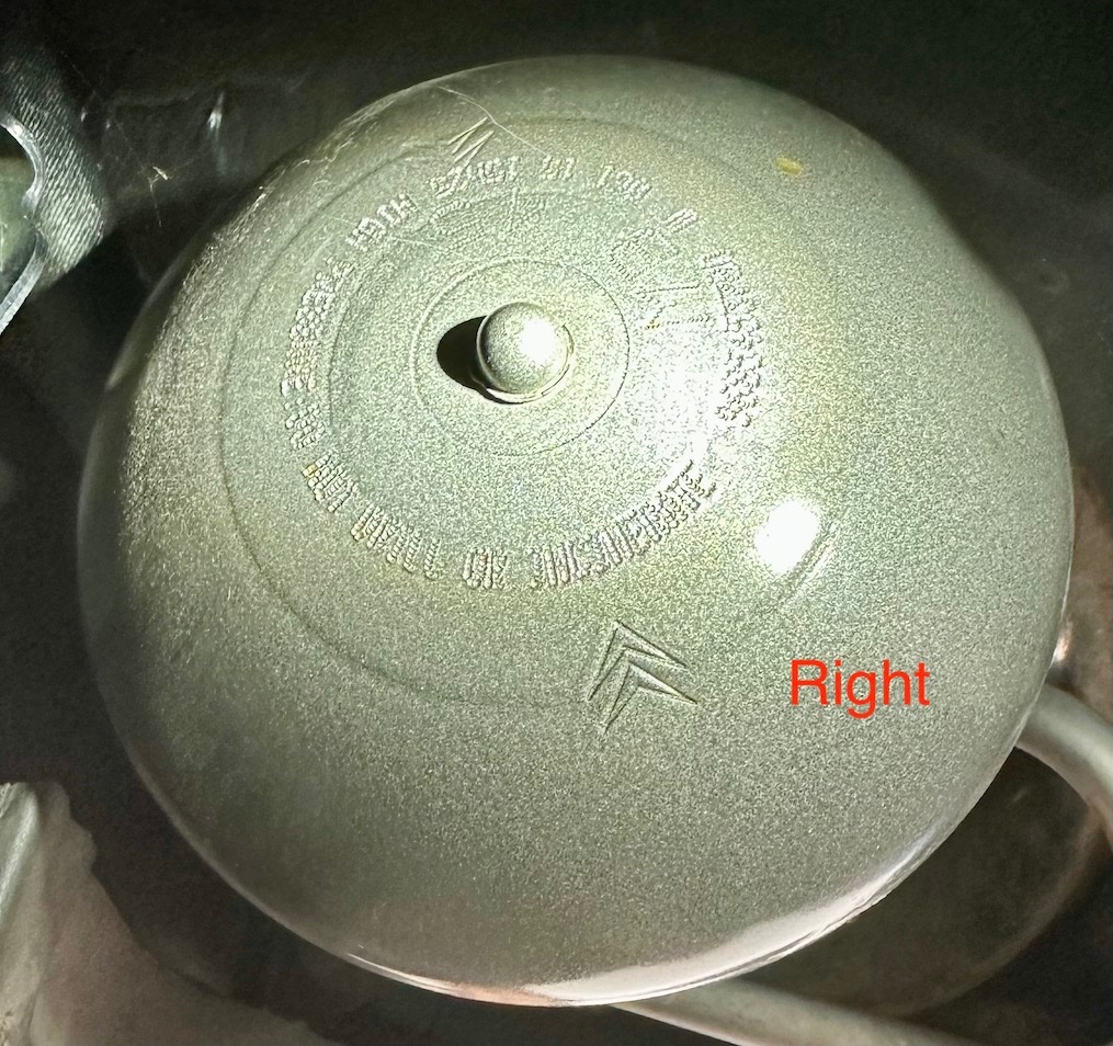

The sphere IDs in the middle are correct (MB 45) which indicates the suspension ID number and the pressure. In this case Front spheres (corner) and 45 Bar pressure which is correct for this engine. However, the markings for the part on the left sphere are hard to make out as the camera light and angle is making it hard to see, but appear etched or worn down. This on the face of it could indicate a re-used sphere.
So may be worth looking at replacing these or grabbing some when you head this way (although I'd order ahead first from your chosen supplier).

The one with the bad markings (not worn, just badly embossed) is the one I replaced 3 years ago. Hard to get a readable photo with it in the car. That makes is suspect (of not being genuine) but it does have a similar amount of bounce as the other side.
So unfortunately it's the middle one that's most questionable.
