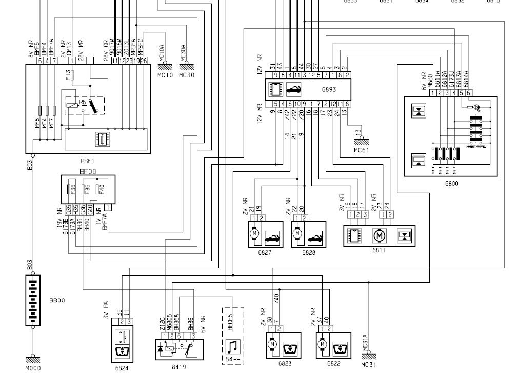

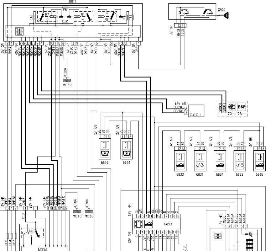

OK so here is the wiring diagram for the roof, I've split it into 2 to make it easier to read. As you kan see there are plenty of interlock microswitches.
You can look up the component codes Here > https://frenchcarforum.co.uk/wiki/Elect ... ring_Codes to identify what each component is.
First thing you might want to check is that on the 12 way Brown connector of the roof ECU that pins 4 & 5 have a good permanent battery supply & that pin 8 has a good earth.

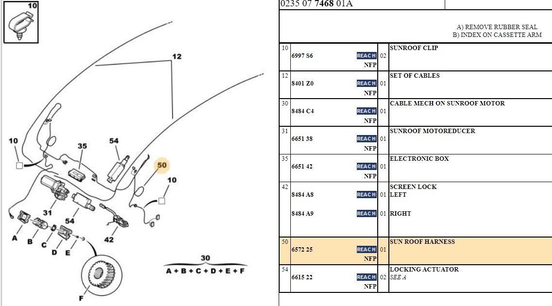

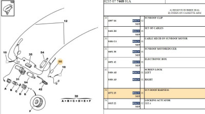

Re: Citroen C3 Pluriel Roof HELP
If i remember right the microswitches are part of the roof harness (number 50)
