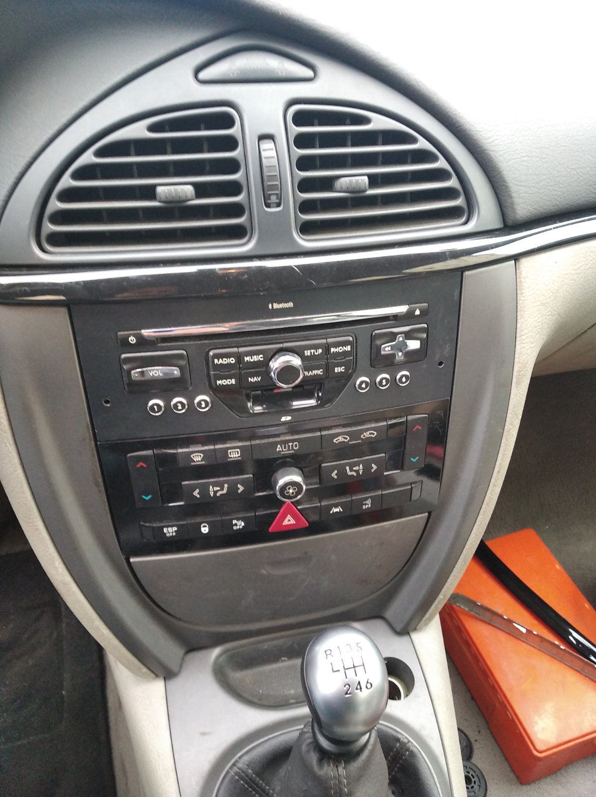

So the problem was solved according to the instructions with the connection to the black connector on pin 6. I just had to change the configuration in the radio, so instead of a multiplex amplifier I had to set it to a standard amplifier. There was a problem with the volume control, which I managed to solve in this way
Now I just have to solve the problem with antennas and poor reception

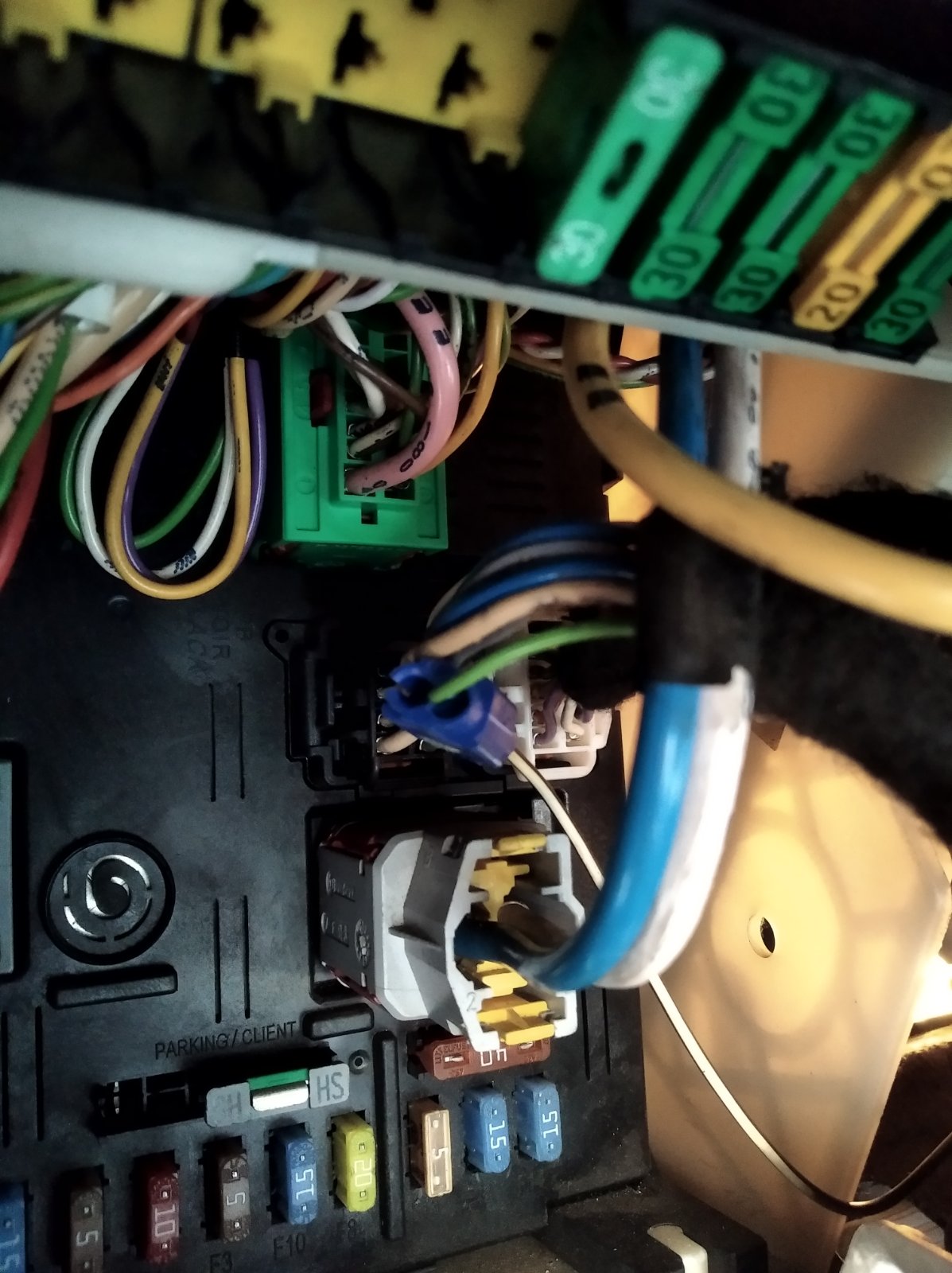

could you tell me where did you take the remote wire ? pin 6 in which compartiemnt ?
SHAKAL007
- Posts: 18
- Joined: 30 Jan 2022, 10:13
- x 2
Re: Replace RT3 to RNEG - problems
I took the connection in the fuse box under the steering wheel, there are two sockets next to each other, white and black, and from that black I took the cable from pin 6 and connected it to the radio cube on pin 11 in A part (there are 4 x 4 pins to the speakers and further control)
