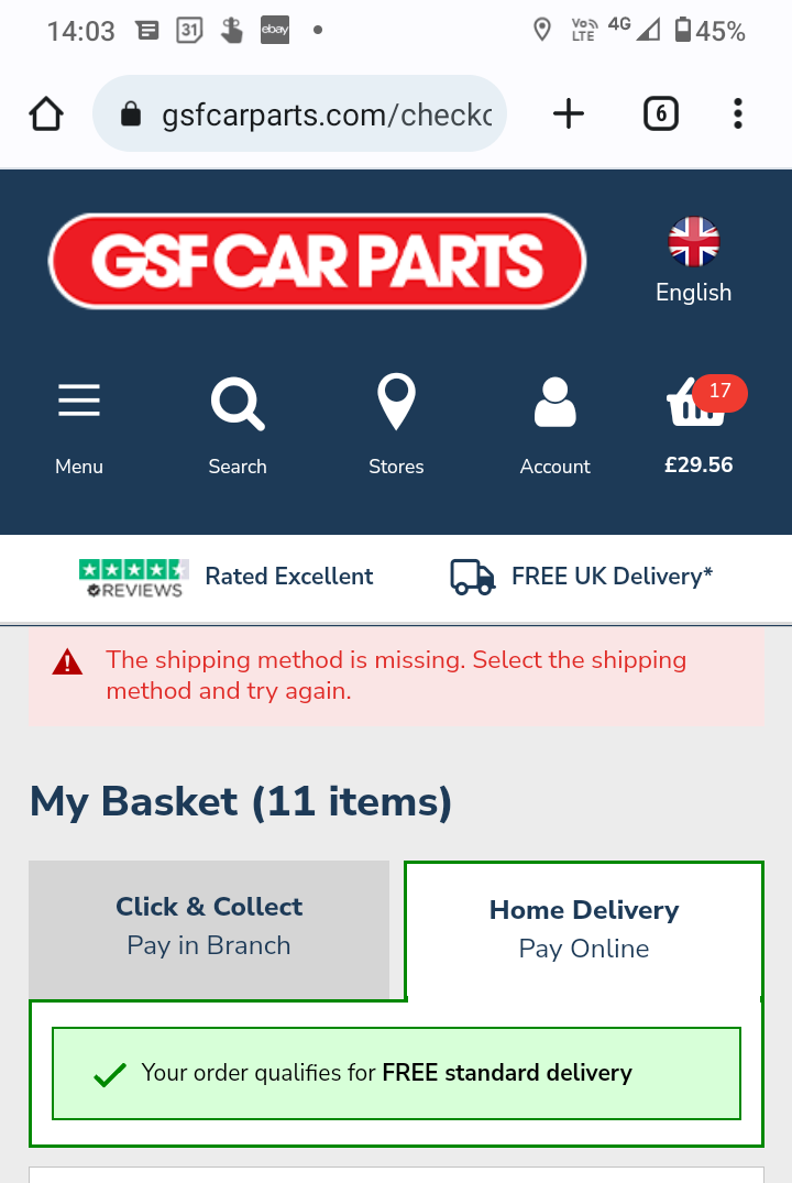

Hell Razor5543 wrote: 02 Dec 2022, 18:34 If you sign up for their news letter you can get quite a few quid off at GSF (sometimes as much as 65%). I just checked, and there is 65% off Saxo wheel bearings if you have signed up.
Yes, good discount at present, just unable to actually complete the purchase!
Have tried online via phone, then via desktop, tried ringing helpline a couple of times this afternoon, live chat (offline, so send a message) and most recently futile bitching at them via their Facebook page.
On their site, one page tells me "no delivery option for the items in the basket"
Same page says all items in stock for home delivery, and basket qualifying for free delivery.
Another page says "postage option missing" as pictured.
No stock in branch otherwise would go pick them up directly.
Nothing wierd or difficult to post (I e. Not car battery or big liquids oil /coolant , no aerosols, all small items) so just bamboozled as to what's wrong!
