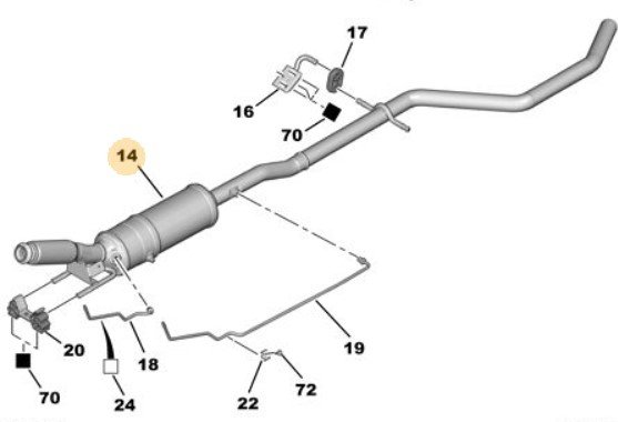

Also where exactly is the DPF located on the car? Under the engine to the back?

On the 2.0 the DPF is located on the underside of the car kind of underneath where the dash board is, you cant really miss it.

Caution is advised when removing the DPF from the catalytic converter / DPF assembly. Be careful not to damage the filter itself.
