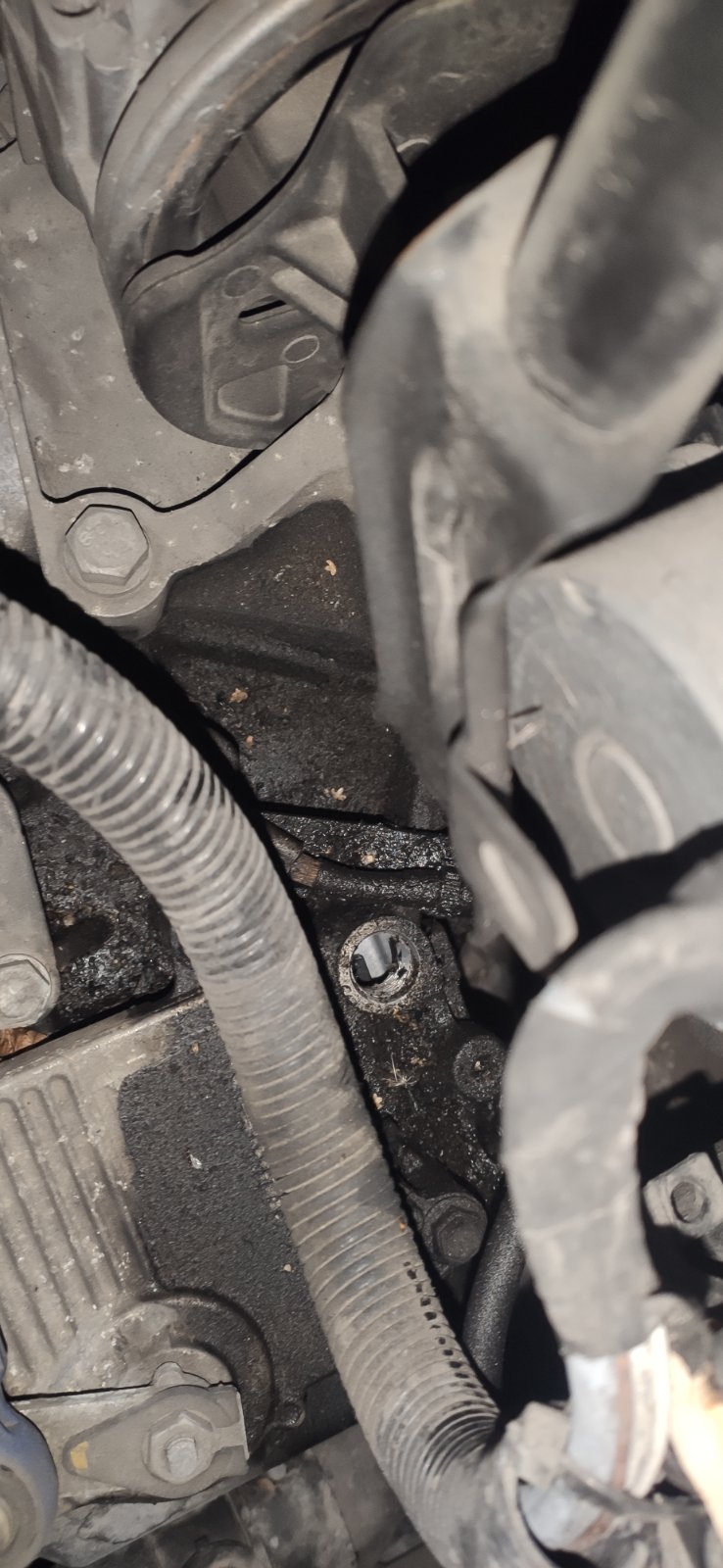

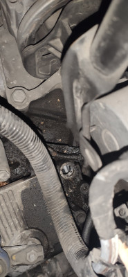

Unfortunately I am back with some bad news.
After removal of the air filter I realised the previous owner had been driving around without the upper oil plug (see attached picture).
That sent shivers down my spine as debree could be in there causing damage to the gearbox.
The owner no longer answers my calls so I have no way of knowing how long it has been like this.
I have temporarily plugged it with an M16 short bolt and copper washer for the mean time.
My dilemma is that I don't have Lexia at the moment and can't perform the oil change (correctly).
All the dealers are booked for the next 10 days and the cheapest one quoted me 550€ for the job.
Given the fact you can only replace about 3 litres of oil at once I was thinking of replacing only 3 liters for now WITHOUT LEXIA, until I get my Lexia (they are out of stock at the moment :/ ).
I would very much appreciate any input on this idea.

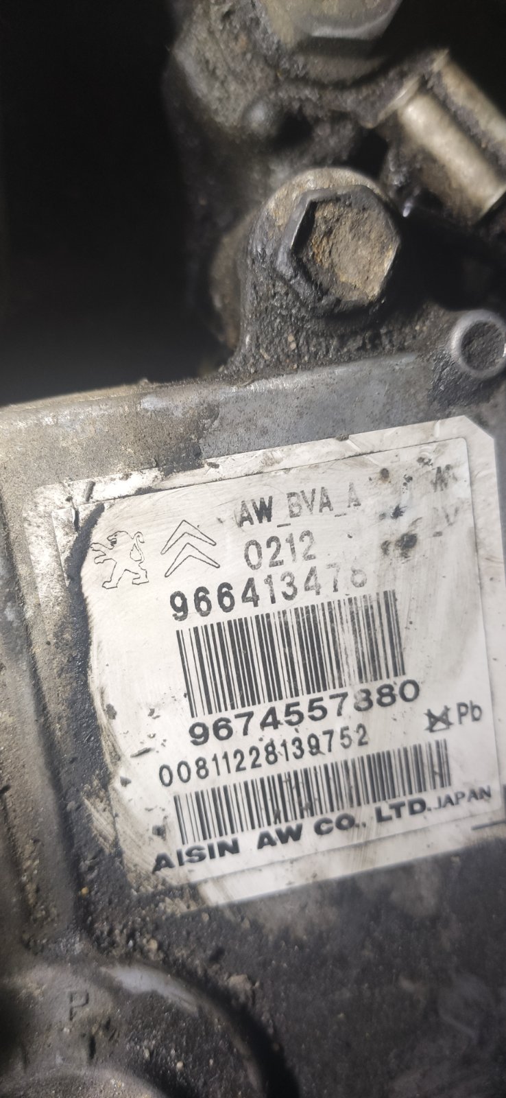

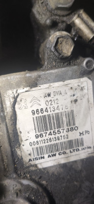

C5X7_2_2HDI
- Posts: 26
- Joined: 13 Nov 2022, 13:56
- x 4
Re: Jerking auto transmission
Thank you for the detailed description of the oil replacement.
However I'm unsure about oil. I think my car is Euro5 car.
If anyone can confirm which oil is cirrect this is the VIN (VF7**************[VIN obfuscated, can be read by forum staff]).
I also must add that the gearbox has been changed for a new one about 100 000 kms ago.
I am adding the picture of the gearbox plate, just in case.
