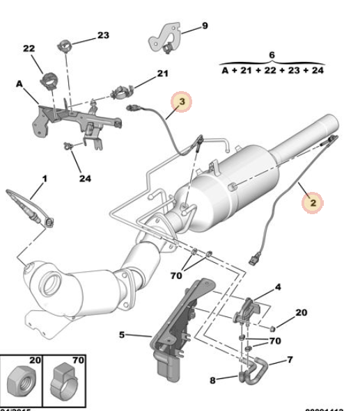

Ok, so here here is the parts diagram:
Item (2), Downstream Gas Temp. Sensor, part: 1606611680, £163.08
Item (3), Upstream Gas Temp. Sensor, part: 1606611580, £161.81
The Exit particle filter pressure pipe is shown as (7), part: 1607433880, £17.98
The Entry particle filter pressure pipe is shown at (8), part: 1607433980, £17.98

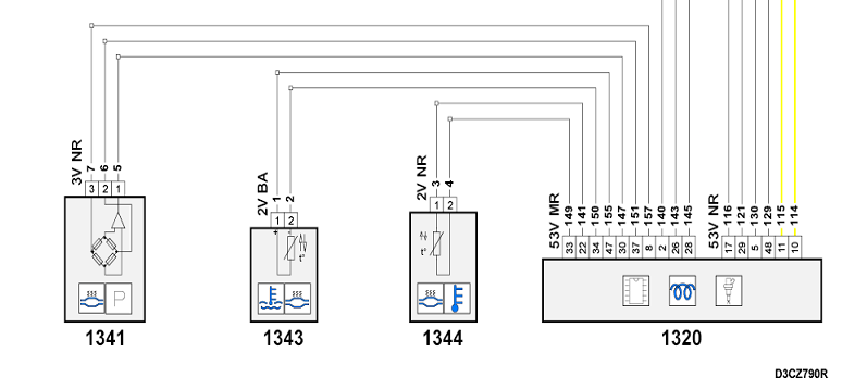

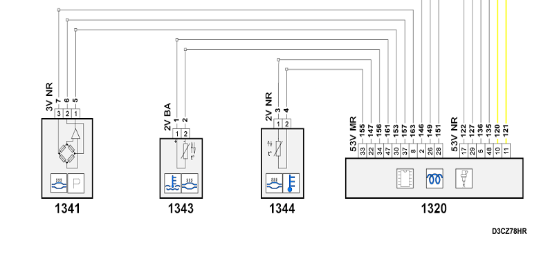

There are 2 possible wiring diagrams for this vehicle and each has different pin assignments for the exhaust gas sensors, so I'll put both up and you'll have to determine which is which:
1341 : particle filter differential pressure sensor /
1343 : downstream exhaust gas high temperature sensor /
1344 : upstream exhaust gas high temperature sensor /
1320 : engine ECU /
Option 1:
Option 2:

Option 2:

That's really helpful Marc, I'm seeing the sensors on Autodoc, but given the state of post and deliveries in this country at the moment, I'll probably go to Arnold Shark when I'm in Inverness next week, the decision will be, will it be my right arm and leg or my left that I use as payment!! Next challenge is to extract the sensors, might be easier to drop the dpf.
- x 6956
Re: Boxer 2.2 HDI White Smoke During Regen
Hi John
Good luck with that - I've put up a procedure for the removal and refitting for you along with the torque settings. It can be found in the resources Section here:
Peugeot Boxer III Puma 110 Exhaust Temp Sensor Replacement

Refering to the diagram posted by Marc above, I think:
Cat. converter upstream sensor = Item (2), Downstream Gas Temp. Sensor, part: 1606611680
and
Particle filter upstream sensor = Item (3), Upstream Gas Temp. Sensor, part: 1606611580
Does anyone know if this guess is correct?
