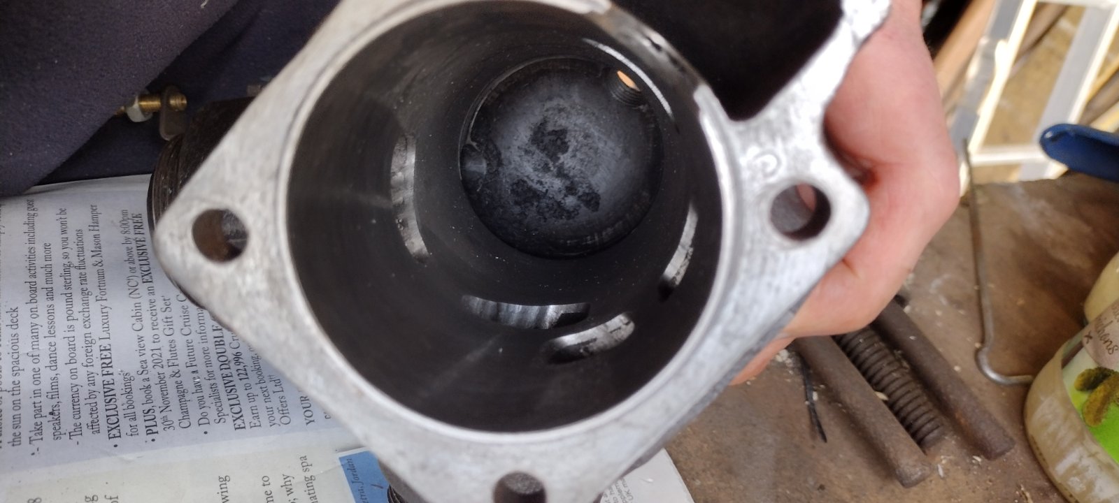

Finally got around to looking at this! In the box was the barrell, which Vintage Engines in Lancaster have sleeved. Here is the inside, much nicer, you can just see in the ports where the sleeve is:

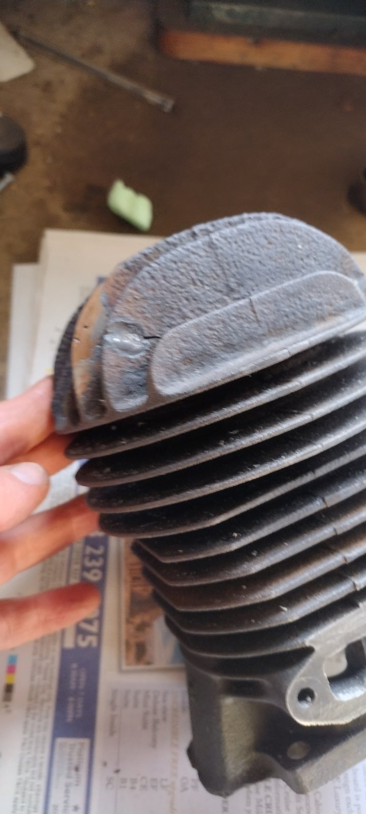

Unfortunately whilst there it had some more 'History' added to it 🤣 it escaped from the clamps and broke a couple of the fins on the head. They welded them back on, and repaired the missing bit, and then refused to charge anything for the labour for doing the sleeve (or the head repair) so it only cost £70 in the end.
Dark evenings now so on with trying to get it back together and running. I have until Easter next year to beat 70 years since it last ran. Hope I make it!
