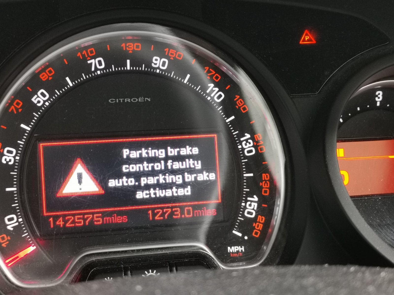

Hi all! I hope someone can help! I'm getting this. The "P" is always lit. I've changed the handbrake switch but it's still there. I'm unable to manually operate it. I've got a 2010 C5 2.0 Hdi 163 Exclusive. I tried resetting the BSI but all that did was wipe my clock. Helppp! Thank you!!

That will need some further looking at to find the issue. There will likely be fault codes generated which will need a suitable diagnostic tool like Diagbox to extract.
This may be a fault with the ESP ECU (which is the master ECU, where the EPB is the slave ECU in the relationship), or purely a fault with the EPB part itself. Either way we would need some fault codes to help further, which you very likely will not get with a generic OBD II code reader.
