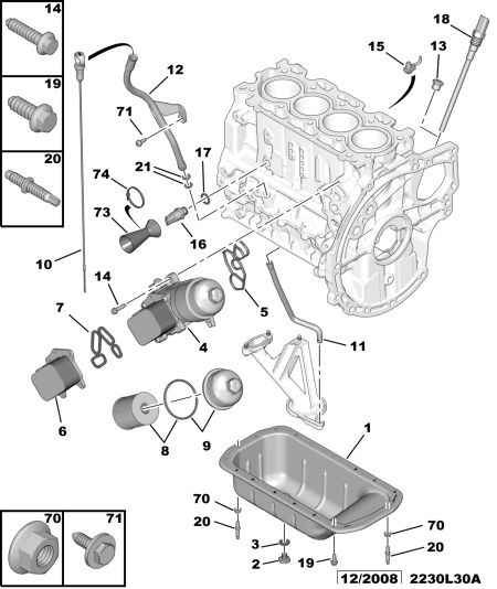

Had the same problem with the wifes C4 1.6 hdi.
It snapped in the same place, I was advised to leave it and just get a new dipstick, After a while the second one broke, I removed the sump and found the lower portion of the dipstick tube to have a severe bend in it and the 2 broken pieces wedged in it, they would not go any further to the sump. I removed the pipe and cleared them out, the got another dipstick.
Number 11 in this diagram is the tube they were stuck in
