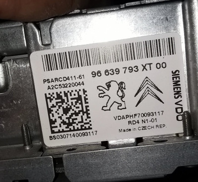

As has been discussed elsewhere, I have a 2008 C4 Picasso with Hands Free Kit and an RD4. That means it has calls-only Bluetooth.
There's a Phone button in the lower left block of the steering wheel that opens the Phonebook / Recent Calls menu, from which calls can be started by choosing an entry using the lower right block wheel and OK button. Calls can also be answered using that OK button, or rejected using some other. It's also posible to use the Phone button during an ongoing call to open a menu with options, such as ending the call. During a call, the RD4 will only play the call's audio, and when ending it will resume whatever it was playing before. I'm quite interested in keeping this working more or less as it is, and that's why I haven't pursued some aftermarket solution.

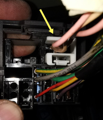

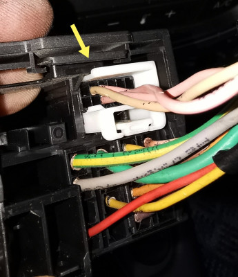

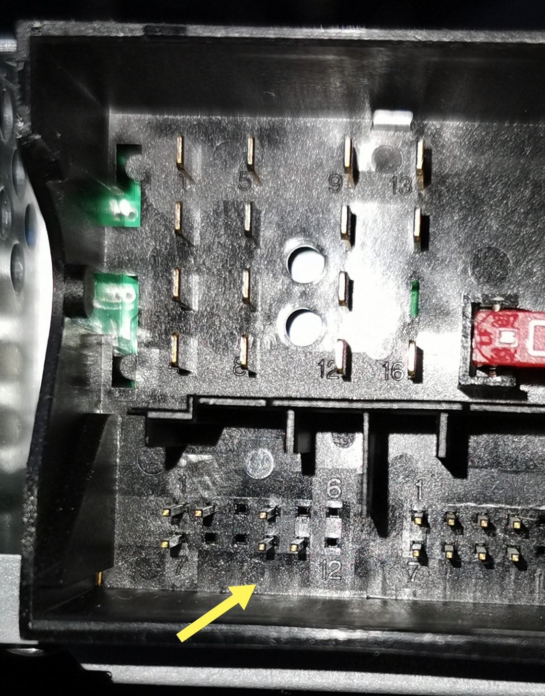

The RD4 has only the quadlock and antenna going into it. The quadlock has wires going into only the A and B blocks, C is unused (I think it's for a CD changer). B has only 3 wires going into it, a beige one into position 4 and two yellow ones into 10 and 11. According to the pin out diagram, those are Aux1 R, Aux1 L, and Aux1 ground. Those 3 wires come inside a black sheath, which in turns comes inside a larger black sheath, in which there are 13 other wires going into the A block.
Now, from this setup, it's not clear to me how the Hands Free Kit works. It must get canbus data from somewhere, because it responds to the steering wheel and the RD4 buttons, and it must also send data back to the car, because the screen shows the menus and call lists and cell connection state. But it can't be one of those 3 wires... I suppose? Those 3 should be only for the call incoming audio. I have no idea where a microphone should be plugged into the RD4/RD45.
The A block has:
Code: Select all
1 yellow     5 green       9 -         13 yellow
2 yellow     6 blue       10 green     14 -
3 yellow     7 green      11 -         15 brown
4 yellow     8 beige      12 brown     16 green/yellow
Interestingly, 14 isn't connected. All the diagrams I've found say it's 15 that is unused, but I think that may be an error.

- Aux1 appears in the sources, but I haven't found a way to use it. There is a 4-pin to USB cable plugged into the 4-pin connector in the back of the RD4, but I don't think it's doing anything.
