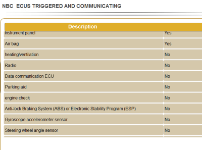

Further update on this
See screen shot from Diagbox
No Comms from ECU back to the BSI via the CAN!
Looks like I need to check the CAN wiring/plug from the ECU?!
