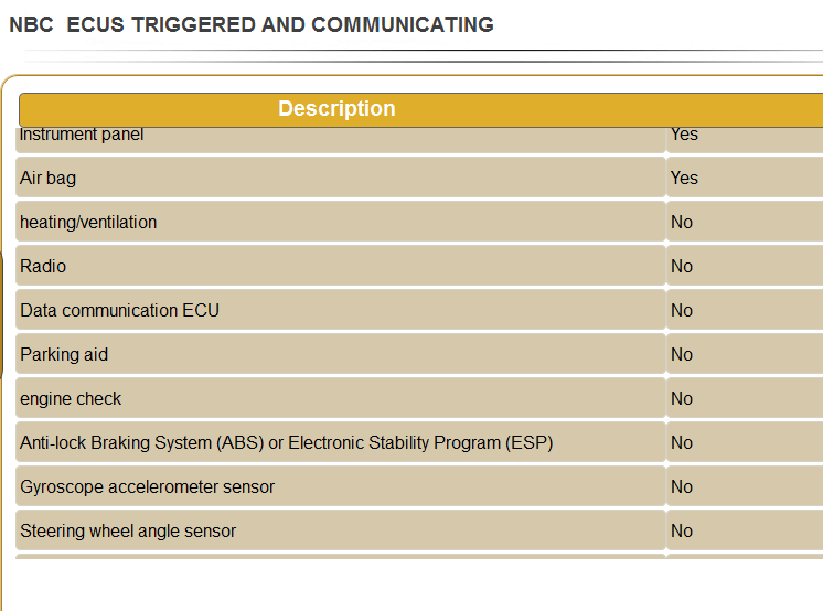

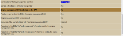

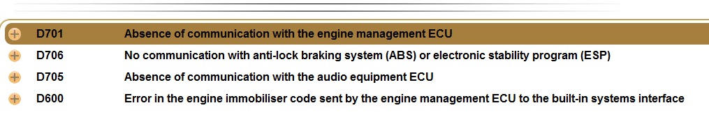

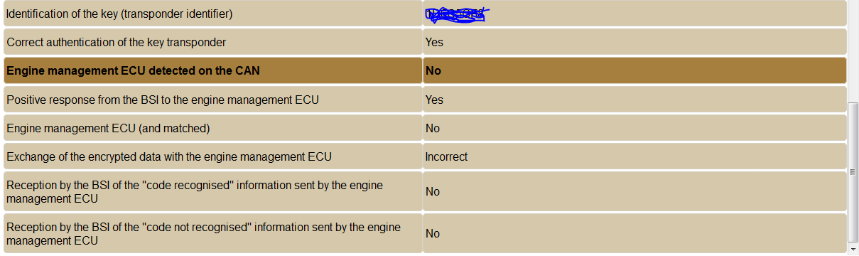

Further update on this
See screen shot from Diagbox
No Comms from ECU back to the BSI via the CAN!
Looks like I need to check the CAN wiring/plug from the ECU?!

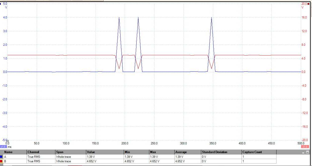

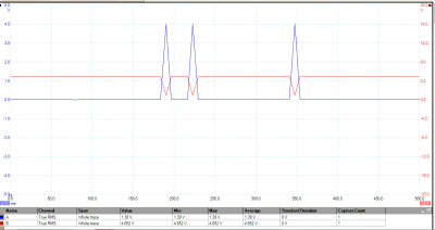

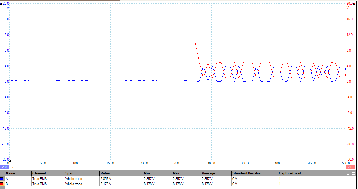

I've had a further look as this with my Scope to confirm my numbers and findings ion the last message.
See the attached!
I don't appear to be able to get the 11.44v off the CAN high at idle. The Scope1 attachment shows sharp peaks whereas the Scope2 shows an overview!
Where is the CAN signal generated? Have I got a goosed BSI?

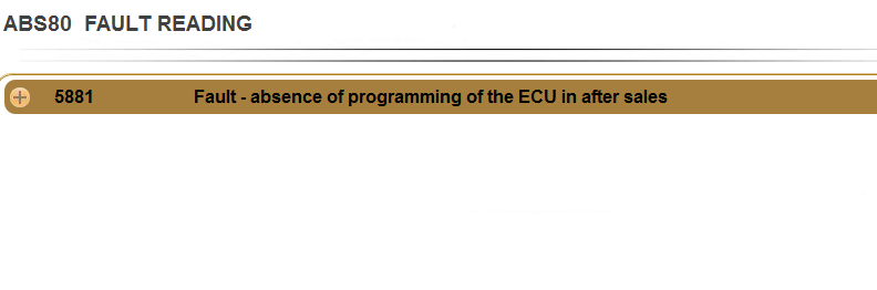

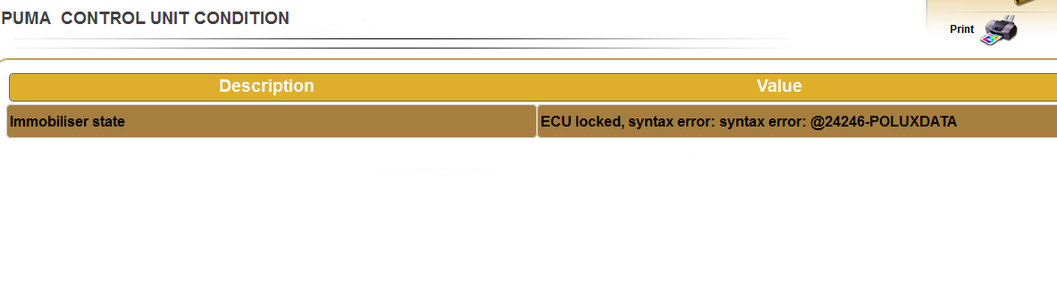

I've also attached some of the fault descriptions from the ECU and BSI.
Cheers.
See the attached!
