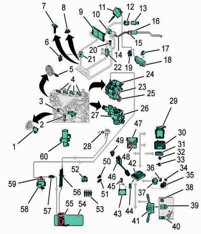

I'll need your VIN to confirm, but if this is the DW10BTED4 138 engine:
The Engine Speed Sensor is item (1)
Your Camshaft Sensor is item (5)

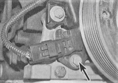

Crankshaft sensor on the 2.0l HDI 16 valve engine (borrowed from Haynes manual)

Gibbo2286 wrote: 03 Sep 2019, 16:49 Crankshaft sensor on the 2.0l HDI 16 valve engine (borrowed from Haynes manual)
I saw a video of a sensor replacement but it was a gasoline engine... and it was the other side(right)... I thought it could be the same side... it seams it's not... ;)
So to get there, you need to go through the passenger side fender (left driving), removing the wheel and wheel cover ... ok... thank you ;)

I'm trying to locate the (crank) sensor on my '07 mkII 2.2hdi auto, it looks like it's just inboard of the pulley, towards the bulkhead.
If that is it, it's accessible from underneath, maybe drivers front wheel off and jacked up (safely of course :) )

Thanks for that, I found the sensor and have changed it but for future ref the VIN is VF7**************[VIN obfuscated, can be read by forum staff].
However, for anyone else that may need to know:
2.2 Hdi MkII 2007 auto.
Crankshaft sensor is definitely located next to the crank pulley (drivers' side, RHD). Reasonable access after removing front drivers side wheel.
10mm nut.
Watch out for the plastic locating lug on the sensor, my was stuck firm and broke off in removal, even though I was gentle with it.
A faulty sensor will prevent the engine from starting or stop it, if it fails whilst running.
