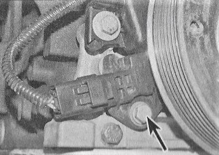

Crankshaft sensor on the 2.0l HDI 16 valve engine (borrowed from Haynes manual)

Gibbo2286 wrote: 03 Sep 2019, 16:49 Crankshaft sensor on the 2.0l HDI 16 valve engine (borrowed from Haynes manual)
I saw a video of a sensor replacement but it was a gasoline engine... and it was the other side(right)... I thought it could be the same side... it seams it's not... ;)
So to get there, you need to go through the passenger side fender (left driving), removing the wheel and wheel cover ... ok... thank you ;)
