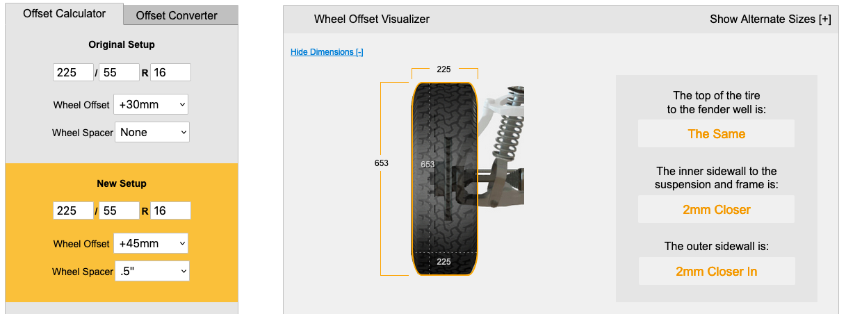

Seems like a lot of wheels have more offset than mine.. Which I guess increases the chance of rubbing 🤔 is there anyway to know what I could get away with?
Ross_K
Posts: 1055
Joined: 18 Jul 2004, 22:26
x 110
Re: identifying wheel sizes..
Unread post by Ross_K »
Try this page...you can put in the old and new dimensions (and play around with spacer size) to figure out what might fit
https://tiresize.com/wheel-offset-calculator/
