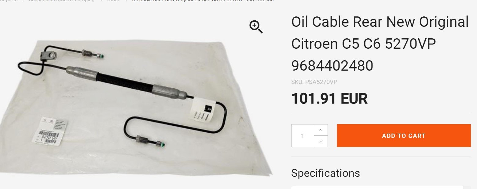

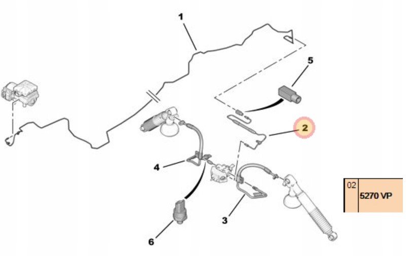

This is the pipe: Anyone know if the pipe and fitting are still available? Parts 2 and 5 in the last picture.
The second picture is the part they will not send to the UK

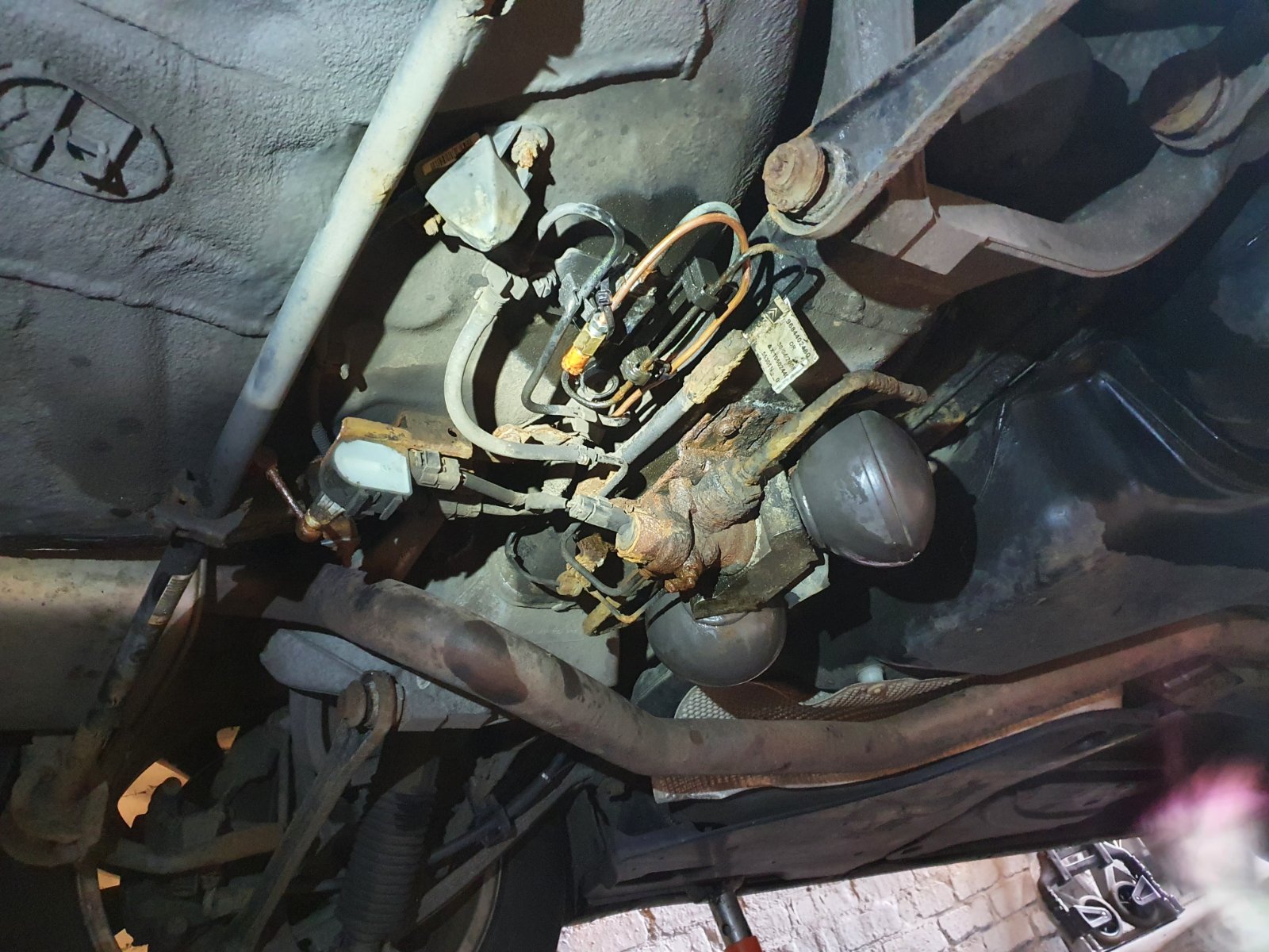

Slowly replacing all the rotten bits at the back: Incredibly the 4 bolts that secure the rear hydractive unit mounting plate to the rear subframe have all loosened! they look like they've been stored in a harbour for the last 30 years but all loosened and that bodes well for replacing the rusted hydractive unit and two rear L & R suspension pipes that I have ready refurbished. I need these two parts first in readiness before attempting to change the lot out. If anyone can check on the current parts availability of these items that would be great!
Anyway, I have finally got the new front to rear hydraulic pipe fully routed from the BHI unit back to the rear suspension Hydractive 3 regulator and I'm happy with that. I now have a problem with the thinner pipe that continues from the straight joiner to the rear regulator. It looks rather rusty and I am thinking it's going to explode at some point in the next 12 months.. This pipe with the part number 55305N is very hard to find! And the only one I found in stock in Germany can't be sent because they will not send to the UK (possibly brexit that I didn't vote for) so I'm stuck. The part number also seems to have changed for later cars because I only see 55305VN or VP and I don't know the difference.. One might be the C6 part number but the diagrams I've seen show a pipe that is identical to mine so I'm unsure.

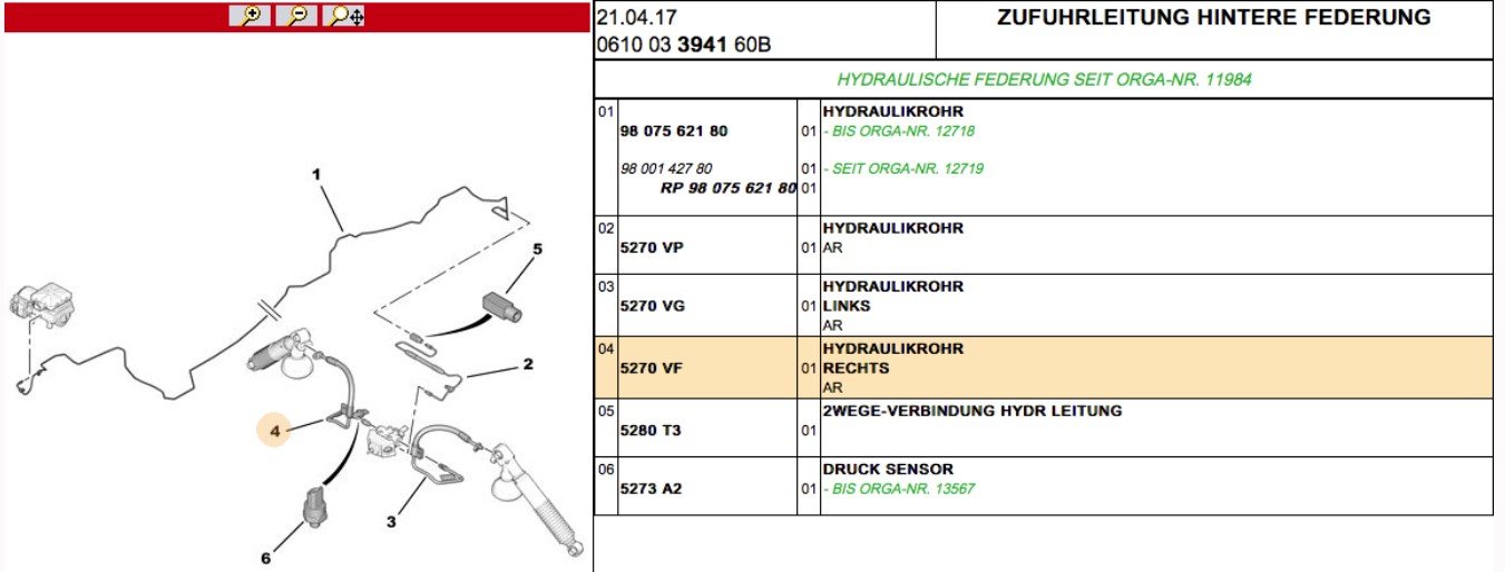

A bit confused Graeme - your first picture is for part (4) and that's not the correct diagram as your build date is 11505 and that diagram is for later vehicles. Part (4) part 5270VF is still available from Citroen, £279.68
Item (2) is part: 5270VP, £191.06
Item(5) is part: 5280T3, £23.47
Both of these are showing as available from Citroen, all prices VAT inclusive.

Thanks Marc, sorry for the confusion - I just clipped the diagrams from google searches. the part VF is the RH rear suspension pipe but I didn't look correctly, it's item 5 after all. I wonder what is different with this part on later build dates.GiveMeABreak wrote: 07 Aug 2022, 00:04 A bit confused Graeme - your first picture is for part (4) and that's not the correct diagram as your build date is 11505 and that diagram is for later vehicles. Part (4) part 5270VF is still available from Citroen, £279.68

Items (5) the union (part 5280T3) and item (4) (part 5270VF) are the same part numbers regardless, there is no other part number for these Graeme.aerodynamica wrote: 07 Aug 2022, 18:24 Thanks Marc, sorry for the confusion - I just clipped the diagrams from google searches. the part VF is the RH rear suspension pipe but I didn't look correctly, it's item 5 after all. I wonder what is different with this part on later build dates.
There are other differences for item (1) the hydraulic pipe for example, specifically for the V6 engined models (2.7 & 3.0).

Working on the C5 today and that rear pipe is looking very corroded...
I couldn't wait any longer to find a replacement pipe since they're totally unobtainable so I set about with plan B that is to attempt to make up a new pipe by joining the one good end I already had from the front suspension regulator I got from Lithuania and the best I could rescue from the original on the car..
Here's what I made up The coiled part is to allow a bit of flex. The original pipe has a short rubber section for this purpose.
And here's the original pipe With a fair bit of wrangling I got it to fit Can see the old front to rear pipe end still dangling down here.
Pressurised, lowered and fully depressurised with the lexia and so far so good.
Unfortunately I couldn't replace the full rear hydractive regulator and the L&R suspension pipes. The RH pipe connection is very inaccessible and I could not undo the securing screw. The LH one did loosen.. I would have got it if it was a standard hex bolt but the Torx screw is a nightmare. I'll get them some day..
I did manage to connect up the new front to rear suspension pipe.. I routed it in place a few weeks ago alongside the original pipe and left the ends unattached because routing it was a big enough job itself and I also fell ill.
Anyway! It's a copper pipe with special adapters on the ends to fit and it works well. So a productive day and finally have no rusty pipe in the car.. well ok the L&R rears but they don't look tooooo bad...
If I can source a replacement pipe end-to- rear strut fixing screw I'd consider removing the struts, cutting the pipe to allow removal and deal with the fixing screws on the workbench then replacing the lot with my refurbished pair of L&R pipes and then of course the rear regulator with the refurb that's been waiting for months.. incredible that one screw prevents all the other stuff from being removed..
Reasonable day overall.
