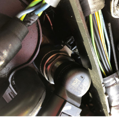

Seems two of the three front diesel injectors have a bit of a fuel leak as per pics (5U3G-9K546-AA)
I've tightened up the hold down bolts and line nuts but still get a bit of diesel leakage
The middle one is nice and clean, whilst the other two are brown all over , so hard to tell where the leak may be. No obvious seepage when running
My quick research is either the bottom copper washer is leaking or the middle gasket its leaking, or both or maybe the fuel return line O rings
Any one done these and any tips eg what can go wrong ?
They seems very expensive new.

Change the whole set for each injector , ive done my old picasso no half measures or there leak again .
Check youtube there lots of videos.

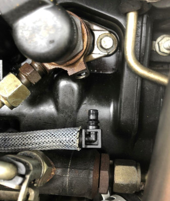

so, got the tools out on the weekend and pulled out all three front injectors on the Hdi.
On pulling off the fuel return lines, I suspect one of the O rings has a cut / snip plus the inside of the fuel return on the injector looked like it had some old blue perished O ring which might explain the leaking diesel. The retaining clips are relatively easy to get off (screwdriver to start and then long nose pliers) but make sure you do not drop them.
Two of the injectors were a bit wet with diesel when pulled out so suspect the copper seal ring at the bottom had leaked a bit.
It look some time to clean the carbon / crap in the shaft / bottom the injectors sit in - I used some spray contact cleaner and lots of small rags on a pronged pickup tool that seemed to do the trick.
The new copper seals I ordered (Renault ones sorry) were twice the thickness but otherwise the same. The extra 1 mm did not seems to upset the joint on the injector pipes and I figured the steel injectors will bed the copper down.
The bent bracket at the top of the injectors seems to act as a tension spring - just need to ensure both sides are equally screwed in till they sit on the top of the injector shaft.
The blue spacers fell out after a run, and not sure what they do anyway maybe act as a warning that injectors are too loose ?. I took the view that they were loose due to the extra 1mm of copper seal
Put it all back together and its running nicely, does not have a diesel smell anymore but still have a small leak from the damaged O ring which I will have to replace (did not have a spare on hand) .
I had a look are dismantling the injector itself but seemed a bit too hard / pointless if the copper seals were the issue
All up around 2 hours
The rear ones will be a bugger to get to .
return line lining had old blue perished d O ring inside

After having mixed results with replacing the O rings on the leak off pipe (eg fixed one injector and then another would start leaking), I bought a new leak off pipe and dreaded fitting it because of the rear injectors and what seems to be a impossible work space.
I finally bit the bullet last week and found it was not as bad as I thought.
You do need to take a few bits off the engine including the heat mat and turbo air tube running across the engine (2 clamps and a few nuts) plus disconnect a few of the wires.
It also helped that I had removed the EGR pipes and fitted a EGR block off kit
The worst part is refitting the injector leak off retaining clips - I tied each one with a bit of fishing line so if I dropped (and I dropped a few a few times), I could find it again - worked a treat
Final result was no leaks (so far)
Seems the O ring for a Siemens Injector leak off pipe is a special size - ID 3.6mm / CS 1.3mm / OD 6.2mm and seems more oval than round -specs I found are CMR086-5 and Star 31086/05
for the record any O ring with OD 6.0mm will probably leak
