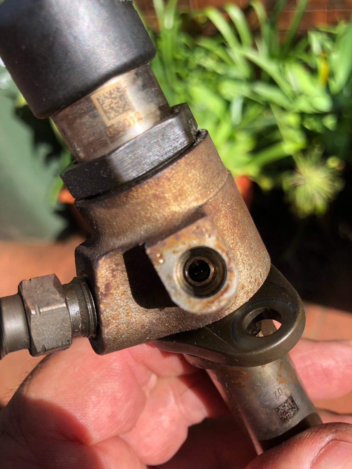

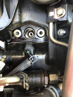

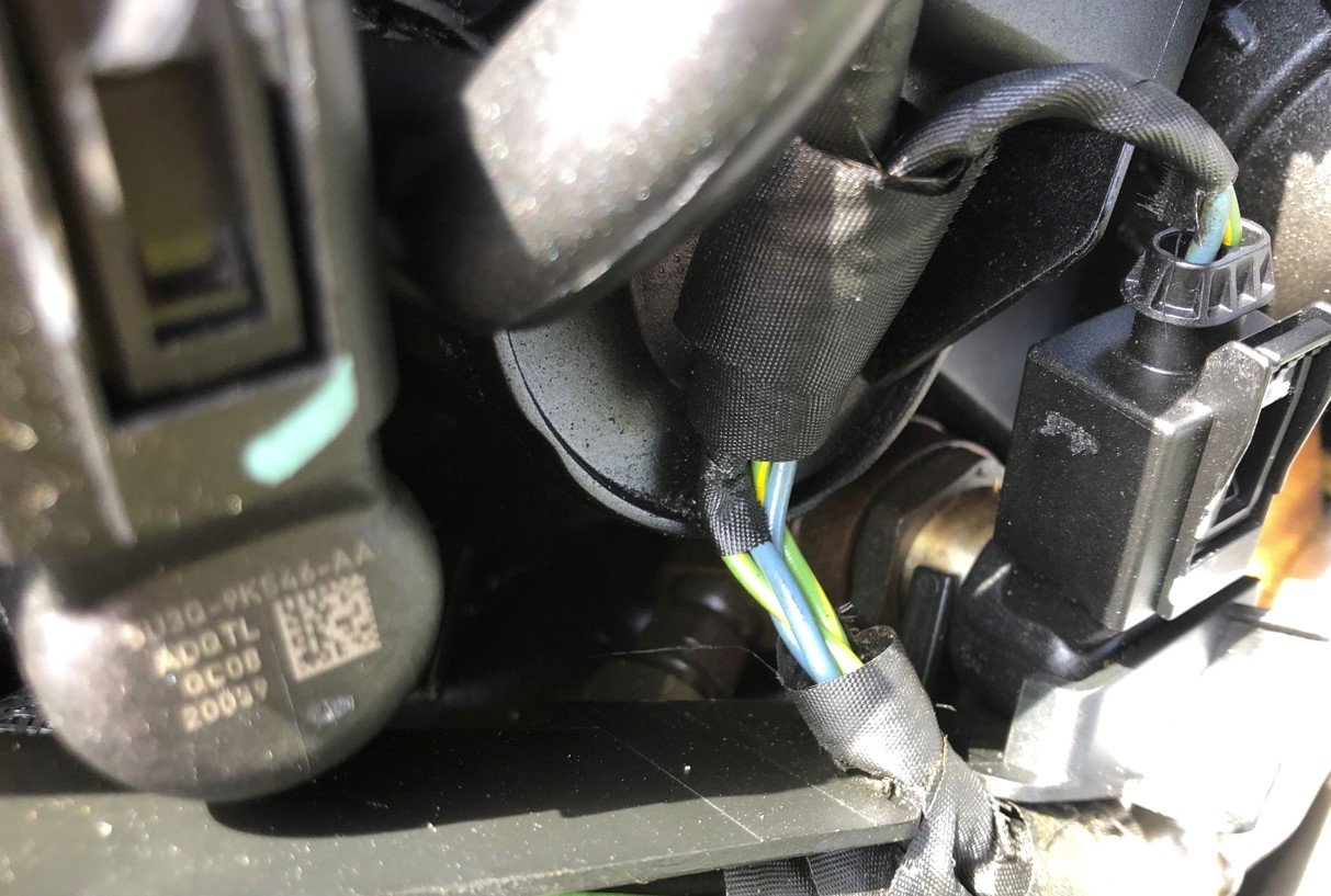

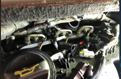

Seems two of the three front diesel injectors have a bit of a fuel leak as per pics (5U3G-9K546-AA)
I've tightened up the hold down bolts and line nuts but still get a bit of diesel leakage
The middle one is nice and clean, whilst the other two are brown all over , so hard to tell where the leak may be. No obvious seepage when running
My quick research is either the bottom copper washer is leaking or the middle gasket its leaking, or both or maybe the fuel return line O rings
Any one done these and any tips eg what can go wrong ?
They seems very expensive new.

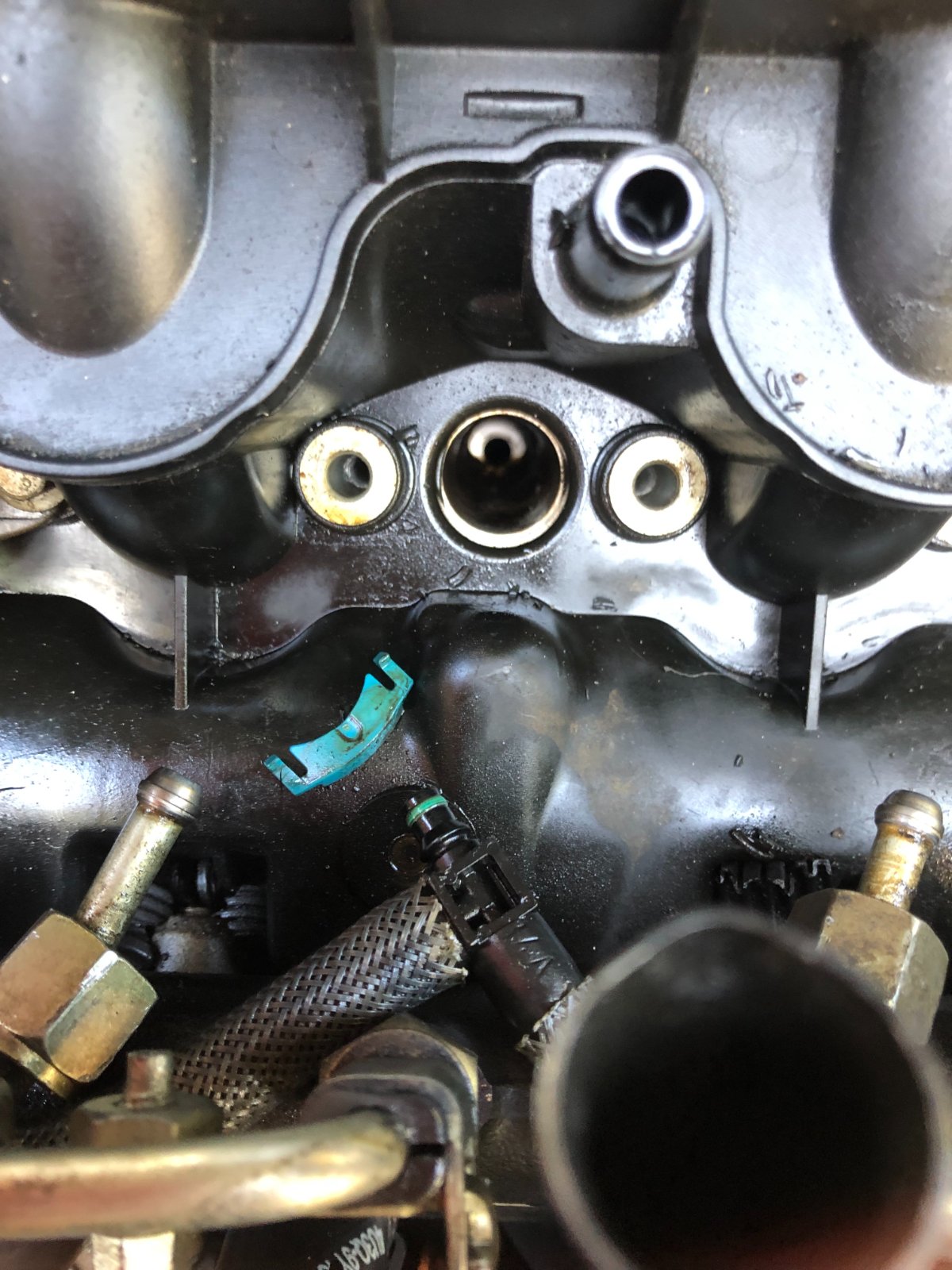

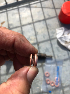

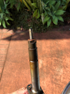

so, got the tools out on the weekend and pulled out all three front injectors on the Hdi.
On pulling off the fuel return lines, I suspect one of the O rings has a cut / snip plus the inside of the fuel return on the injector looked like it had some old blue perished O ring which might explain the leaking diesel. The retaining clips are relatively easy to get off (screwdriver to start and then long nose pliers) but make sure you do not drop them.
Two of the injectors were a bit wet with diesel when pulled out so suspect the copper seal ring at the bottom had leaked a bit.
It look some time to clean the carbon / crap in the shaft / bottom the injectors sit in - I used some spray contact cleaner and lots of small rags on a pronged pickup tool that seemed to do the trick.
The new copper seals I ordered (Renault ones sorry) were twice the thickness but otherwise the same. The extra 1 mm did not seems to upset the joint on the injector pipes and I figured the steel injectors will bed the copper down.
The bent bracket at the top of the injectors seems to act as a tension spring - just need to ensure both sides are equally screwed in till they sit on the top of the injector shaft.
The blue spacers fell out after a run, and not sure what they do anyway maybe act as a warning that injectors are too loose ?. I took the view that they were loose due to the extra 1mm of copper seal
Put it all back together and its running nicely, does not have a diesel smell anymore but still have a small leak from the damaged O ring which I will have to replace (did not have a spare on hand) .
I had a look are dismantling the injector itself but seemed a bit too hard / pointless if the copper seals were the issue

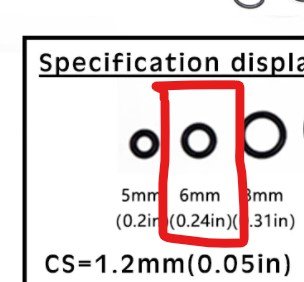

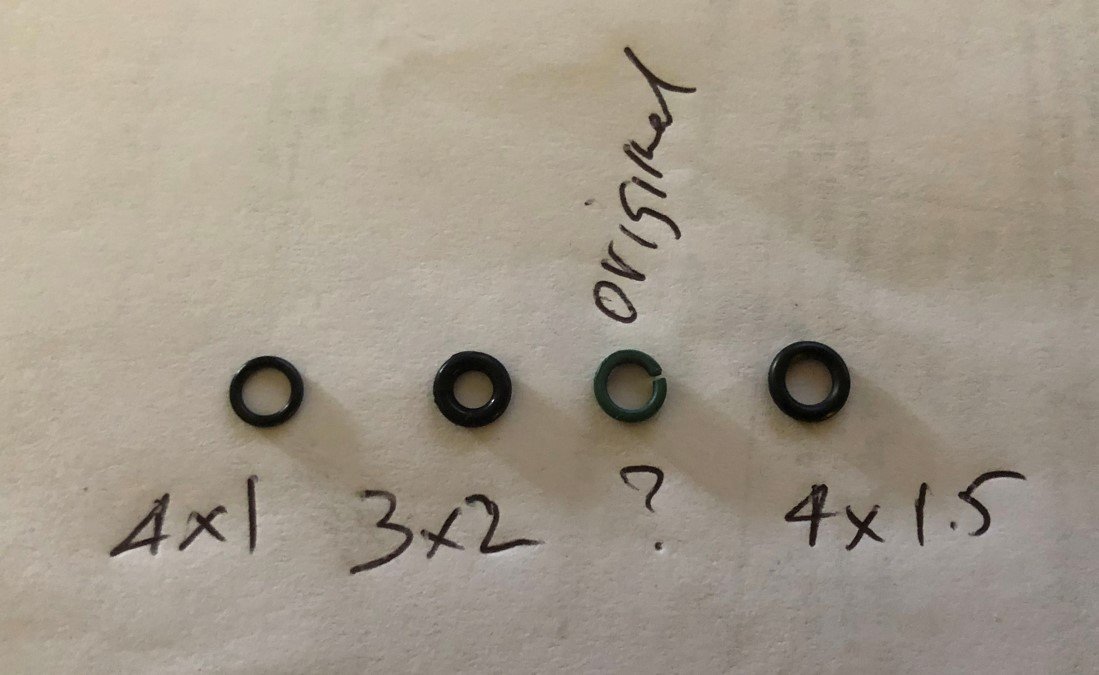

I've been trying to get replacement O rings for the diesel fuel return lines without much success. Seems they are not a normal size (surprise surprise) and it broke when I pulled it off.
Assuming they are French metric, a 4mm ID by 1mm (6mm OD) is too thin, a 4mm ID by 1.5mm (7mm OD) is too tight and a 3mm by 2mm (7MM OD) is too tight.
Tight means no way I can push it back in on the injector.
To keep the car going, I've used two of the 4mmID by 1MM which seem to work okay (no leak so far)
I'm waiting on a order of 4mm ID by 1.2MM (6.4MM OD) and a 3.5MM ID by 1.5mm (6.5MM OD) which might work. The only good news is that they cheap.
Anyone has the actual spec size ?

Seems the O rings are 6mm OD, 1.2mm thick / CS and so 3.6MM ID (or at least that seems like the closet size made)

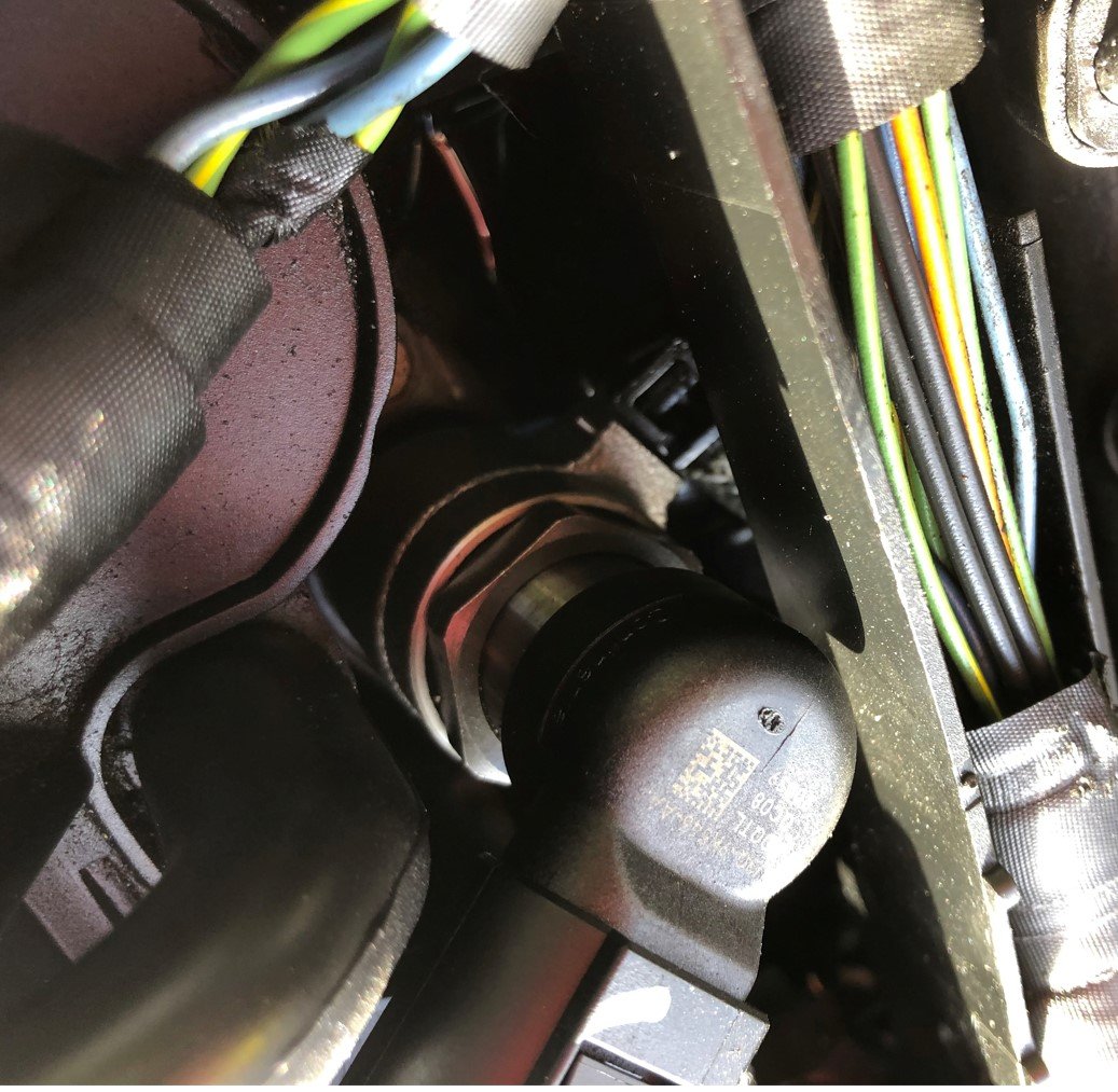

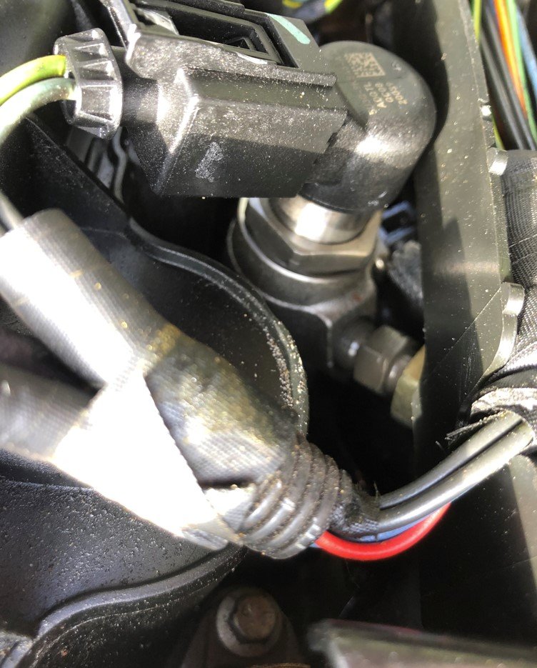

After having mixed results with replacing the O rings on the leak off pipe (eg fixed one injector and then another would start leaking), I bought a new leak off pipe and dreaded fitting it because of the rear injectors and what seems to be a impossible work space.
I finally bit the bullet last week and found it was not as bad as I thought.
You do need to take a few bits off the engine including the heat mat and turbo air tube running across the engine (2 clamps and a few nuts) plus disconnect a few of the wires.
It also helped that I had removed the EGR pipes and fitted a EGR block off kit

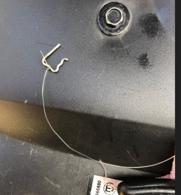

The worst part is refitting the injector leak off retaining clips - I tied each one with a bit of fishing line so if I dropped (and I dropped a few a few times), I could find it again - worked a treat
Final result was no leaks (so far)
Seems the O ring for a Siemens Injector leak off pipe is a special size - ID 3.6mm / CS 1.3mm / OD 6.2mm and seems more oval than round -specs I found are CMR086-5 and Star 31086/05
for the record any O ring with OD 6.0mm will probably leak
I tried a ID 3.2mm CS 1.4mm (giving a OD of 6.0mm but still o.2mm too small) and also a ID 3.0mm and CS 1.5MM (giving a OD of 6.0mm (but I suspect more like 6.4mm once fitted onto the pipe fitting ) and very tight to fit and generally tears the O ring)

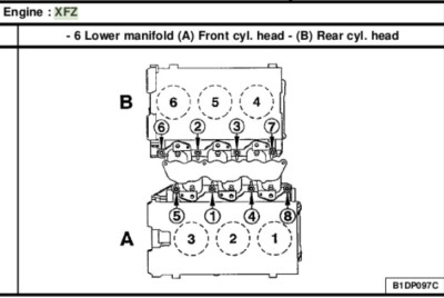

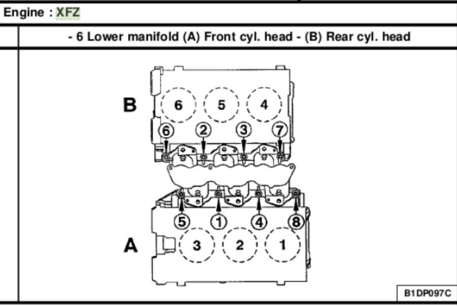

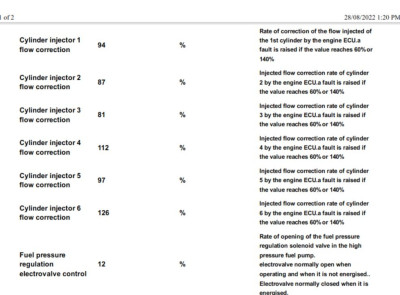

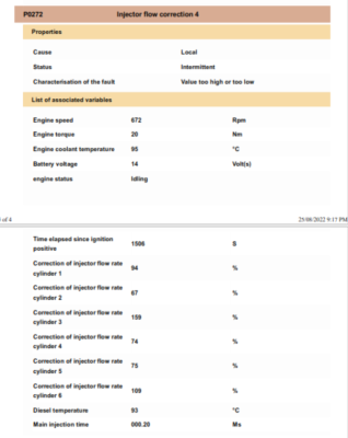

Ive run diag on it and its now come up with a P0272 Injector flow correction 4, but looking at the readings at idle they are all over the place now, compared to before I changed the leak off pipe and I have not touched the injectors. (see snap) At 3400 rpm they are all 100%
Can someone confirm if the cylinder numbering in a 2.7 HDI is the same as on v6 petrol XFZ (only one I could find)
This would make injector 4 the rear back passenger side (with No 5 next to it).

On the way up I used my Carscanner to view the live data - the turbo seemed to be stuck at 0.27 boost and the fuel consumption never dropped below 7.5 l/100 kms at around 80--100 kms / p h
On the way back I suspect the turbo (not sure which one as the hdi has 2 of them) got unstuck as all of a sudden fuel was down to 3/4 l/100 klms and the turbo bounced between zero (on a flat to over 1 boost and then back again multiple times (lots of big hills)
The smoke at the rear on start up also seems to have fixed itself , the P02724 injector 4 error is gone and the injector readings are a bit more reasonable.
However, the P102 still remains fixed (low air flow rear) - given the EGR is now blocked, any ideas why ?

Is the exhaust system all nice and no leaks ? Also check any thing that sucks air vacuum lines and so on, egr can work funny if something that runs in situ isn't working as it should.
Egr works with the exhaust, my manifold had three lose nuts my egr was nagging it was either closed or stuck open and stuck blah blah blah, i did the three lose nuts up , different feeling after and the nagging faults went away. But each car is different. Injectors 4 and 6 look like there in a league of there own there.
Maybe Marc,GiveMeaBreak,might have some ideas hes the one who knows his stuff.

re exhaust leaks - I took some wet towels and tried to block / smother the rear twin exhaust and kill the engine but failed a few times - the pressure build up got too much and so I have to assume the exhaust system has no leaks.
re injector readings - a few weeks ago I did the same Diag test and got different results (eg 1-3 were around 80-90% and 4-6 where all at 100% at idle) so I can only assume some have become clogged up given I have not really driven it anywhere but no idea how. Maybe the last tank fill up was bad fuel ? The readings also seem a bit random

Still hopefully someone can confirm cylinder numbering
