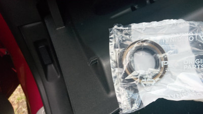

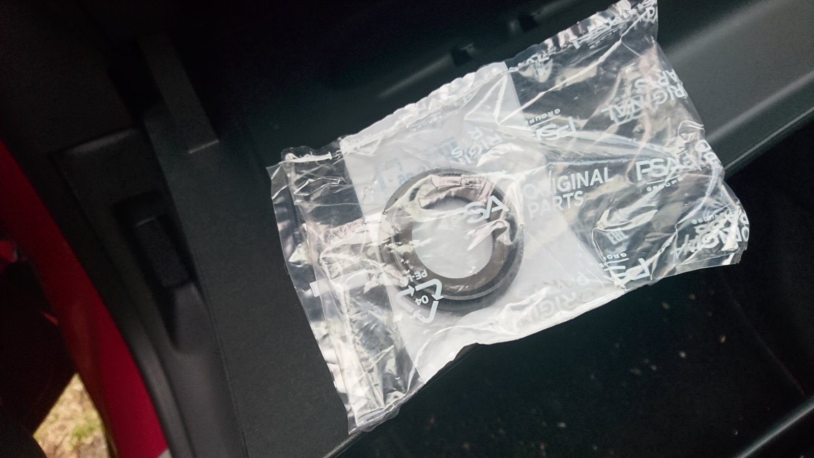

Ok just a quick update as i still need some advice as usual and the MOT runs out on 22/7 so i have a little bit of wriggle room
I ordered both seals from Citroen, both on back order so waited 18 days waiting for a call to say the parts were in before i finally decided to chase them.
Apparently one of the seals has a new part number and the old part number is not valid so they did not dispatch the old part number seal or contacted me to see if i wanted the new part number ???
So today finally picked up both seals as they had the new seal on the shelf but i am a little unsure if it is the correct part.
The replacement seal is for the part number 1675689680 pictures below

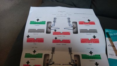

I also needed to get 2 new front tyres as they were getting very close to the limit, however i have been lax in checking them and both fronts were wearing very badly on the inner edges although the other 75% of width were above the legal minimum depth.
So bearing in mind i have had a broken front spring and replaced both front springs i was a little bit shocked at the tracking report as the car does not vibrate or veer when driving.
Not getting the tracking done yet as when i get the seals replaced it will need redoing anyway but any thoughts on should a garage check the tracking after replacing front springs as the O/S/F track rod end needs heating up to free it off so i know it was not done when the springs were replaced.
Below is the tracking report

Re: C4 2010 2.0 Hdi issues help needed.
Just a quick update on the part number for the seal in the pictures above.
i have phoned a couple of Citroen Dealerships outside of my local area and i have been informed the part number 1675689680 has been replaced by 9837728580 as the original part number is showing as unavailable and requested to order 9837728580 as a replacement.
Fingers crossed it is the correct part as it does look the picture in the parts diagram
Colin
Colin
Just a quick update.
The seal part numbers appear to be correct as both were fitted and no more leaks
Price for MOT full service oil/air/fuel/pollen filter and oil change + both driveshaft seals replaced inc gear box oil top up £ 499.50
That i think is pretty fair and no advisories on the MOT
Colin
