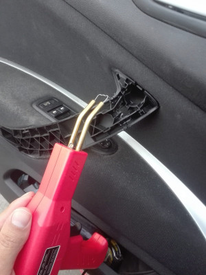

hello everyone. I'm here to show you how I handled the situation. Thank you
