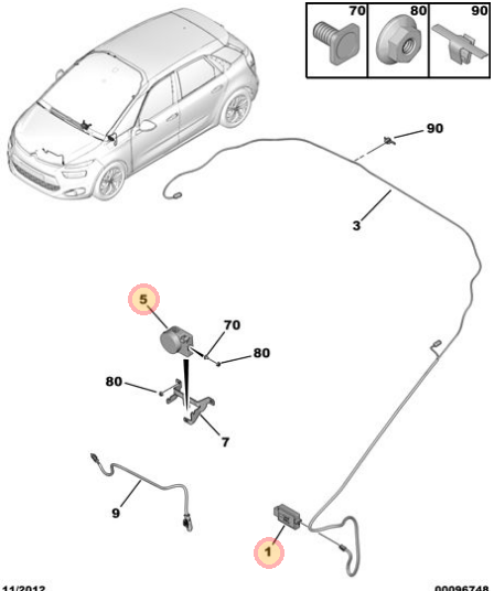

Ok, here you go and thank you for your Forum donation. Any further parts requests, you can post them up on this thread:
viewtopic.php?t=69962
Item (5) is the Siren, Part: 9677756080 £135.95
Item (1) is the Alarm ECU Part: 1607747880 £266.59
I've included both items just in case. These are available new direct from Citroen VAT inclusive as above, and you now have the part numbers in case you want to source a second hand unit.
Bear in mind that the siren and the alarm ECU have parameters that may need configuring.

thanks for the diagram and part numbers m8.

hi would you have the diagram location of the siren and the alarm unit located in the car?
x 6950
Re: 2015 C4 Picasso alarm/BSI problem
Siren (8605), ignore that it says 8602 - it's an error.
Alarm ECU (8602)
