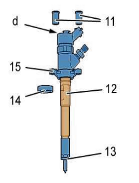

You should have Bosch injectors on this vehicle so an 8 character code shown at 'D': This is the classification, which I believe is different to the code, so as long as you have the right classification you should be fine on these.

Yes, some early injectors don't use coding and some like Bosch, Siemens use just a single classification number for all the injectors. That's what I mean by 'classification' and if this is the case then the same 'class'
(i.e. class 5 or class 6) injector is used - so the class is the same for injectors 1-4. If the class of injector is changed, then the ECU must be notified of the new class. For these, the codes are the same and not unique unlike the injectors with a different code for each injector.
So I can't help you as like you, I won't know what is on your injectors.
But yes, if they as bad as they sound it looks like time to replace them, in which case you will have the codes on the replacements (or classification) depending on the actual injector part number.
