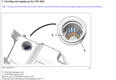

Hi ,
I wanted to check the LDS level of the suspension so I connected my Lexia and depressurised the system(after lowering the suspension to the lowest position) and when I removed the cap a lot of fluid started to leak. After removing enogh fluid so that the level is between "a" and "b" I drove the car and the suspension is a lot stiffer now.I read other threads, but there wasn't any concrete answer. Should the level be checked at lowest position or lowest position and depressurised?
Also I forgot to disconnect the battery as it said in Diagbox. Is this a problem?
C5 X7 LDS level

Both ways to check should be valid. You probably need to bleed the air out of the system, it's why the suspension is stiffer. I believe GiveMeABreak detailed how to do it in this post:

1) The LDS suspension fluid level must be checked with the car on the lowest setting. Although recommended, you can do this without depressurising the system, as there is an allowance. In your case the system has been over-filled.
2) The procedure you are referring to is for specific operations on the hydraulic system, where you do not want the pump engaging whilst undertaking work, hence why the battery needs to be disconnected. It is not required for checking and topping up the fluid levels.
