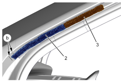

When i worked at a Citroën dealer i heard about wind noise from the door frame sealing area on the C4 Cactus.
There was a service bulletin for this eventually.
So check with your local dealer if they can find the TSB

Re: C4 Cactus 1.6 BlueHDI 2014 whining noise
Citroenguy is correct. The TSB is reference "a2aw012xq0", so they should be able to locate it under the "front door / diagnostics" section of the software system at the dealership.
The fault results from poor adhesion of the front door seals as shown below:
The solution is to place foam inserts as shown here:
They subsequently did this on future builds. So obviously a poorly manufactured seal.
