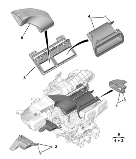

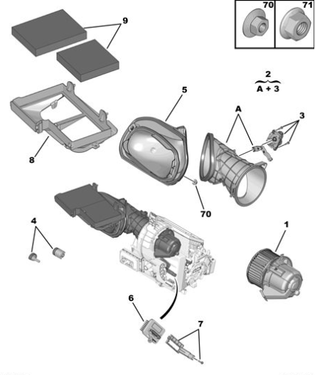

That would make sense relating to the air intake and ducting. When were the pollen filters changed last? A lot of bugs, leaves and other debris can accumulate in the housing once the filter gets blocked.
Pollen Filters
Air Ducting (You only have (3), (4) & (5) on this diagram.
Air Intake
Pollen Filters
Air Intake

I replaced the pollen filters about a week ago to see if it would make a difference. The old filters looked brand new but I changed them anyway. No difference.

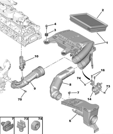

I will have a look in the ducting with a small camera I use for inspecting piping in a different context. The air-intake system at the front (6 in the last picture) is a bit loose - as is all the pipes that go to the air-filter box on top of the engine. I have seen this being broken on lots of Cacti because mechanics break it when changing air filters. Could be that too. I can gather that it will be a lot of detective work to solve this! Hoped somebody else had experienced the same

No, I don't have a roof rack. It sounds very distinct as if it comes from the middle/right side of the car. It doesn't appear to be related to the air ducting as it's pictured above but rather the air intake to the engine. Next step is to disassemble the entire intake and carefully re-assemble ensuring everything fits as it should.

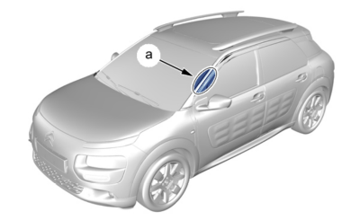

Citroenguy is correct. The TSB is reference "a2aw012xq0", so they should be able to locate it under the "front door / diagnostics" section of the software system at the dealership.
The fault results from poor adhesion of the front door seals as shown below:

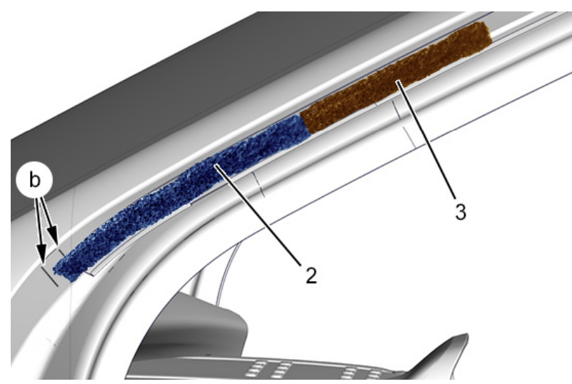

The solution is to place foam inserts as shown here:
They subsequently did this on future builds. So obviously a poorly manufactured seal.
