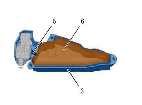

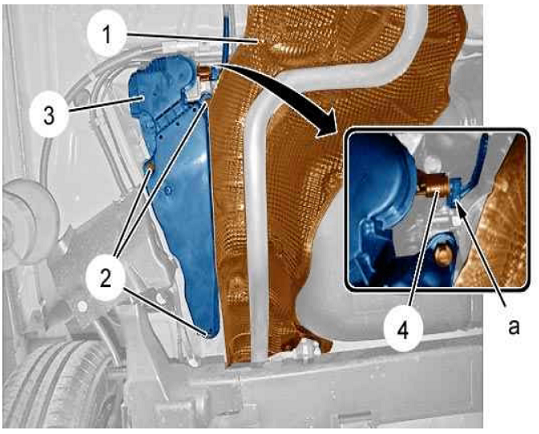

GiveMeABreak wrote: 03 Nov 2018, 09:06 Ok, so I've just rechecked everything for you and your 207 actually uses the flexible pouches and NOT a tank itself. The flexible pouch is contained in a rigid casing. Extreme caution is recommend when removing and fitting these pouches, as you a) don't want to get any of the liquid on your skin, nor split the new pouch on insertion.
So the good thing with a pouch is you don't need the hassle of filling it through a gravity drip.
The Additive Pouch Housing is shown here.
16 & 17 are the shell casing parts and 15 is the Additive Pouch
The part number from Peugeot for the 3L pouch is 9678033680. They charge £182.38 for the pouch inc. VAT, so not much difference in it.
Now to be honest, there are genuine Citroen / Peugeot pouches on ebay - one new one here for about £163...
https://www.ebay.co.uk/p/Genuine-CITROE ... 426&chn=ps
...which would save a few quid - but be cautious of buying some that have been recovered from a salvaged vehicle! - If they say "used", ignore them. You don't know how much is left in the pouch and of course that can cause the ECU to think there is more in the tank than there actually is, as it is expecting 3L to be replaced.
Here's the procedure
  • Where protective gloves.
  • You will need to raise the rear left of the vehicle too gain access.
Be wary of fluid running back from the pipes when disconnected (Suggest covering with a small plastic bag and a rubber band).
Disconnect the connector ( as "a").
Uncouple the pipe (4).
Release the fixings (2) by a quarter turn; By means of a screwdriver .
Slightly move aside: The heat shield (1).
Remove: The lower housing (3) with the flexible reservoir .
Detach the flexible reservoir (6) from the lower housing (3).
Uncouple and close the pipe (5).
CAUTION: The flexible reservoir (6) must not protrude sideways from the lower housing (3) : Risk of damage (On reassembly) .
Refitting
  • Refit: The lower housing (3).
  • Turn the fasteners (2) a quarter turn.
  • Connect the connector ( as "a").
  • Connect the pipe (4).
  • Reset the additive counter to zero
  • Perform the actuator test "refilling the pipe: additive pump - additive injector"; Using a diagnostic tool.
