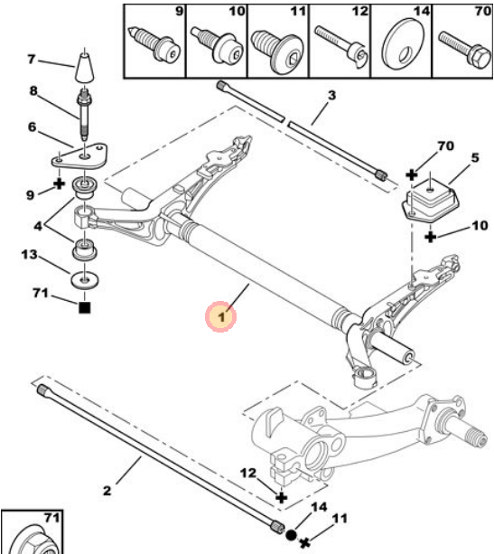

I am looking at replacing the rear axle on my VF3**************[VIN obfuscated, can be read by forum staff] PARTNER VU (M59) SHORT VAN '600' 1.9 D 71 (DW8B)
Is there a difference between the Peugeot '800' axle and the '600' axle. In other words, will either fit with no modifications?

If you're talking about the rear suspension crossmember here shown as item (1), then yes they have the same part number for the 600 and 800 vans:
Original part now superseded: 5148G1
Replacement Part: 9830149780

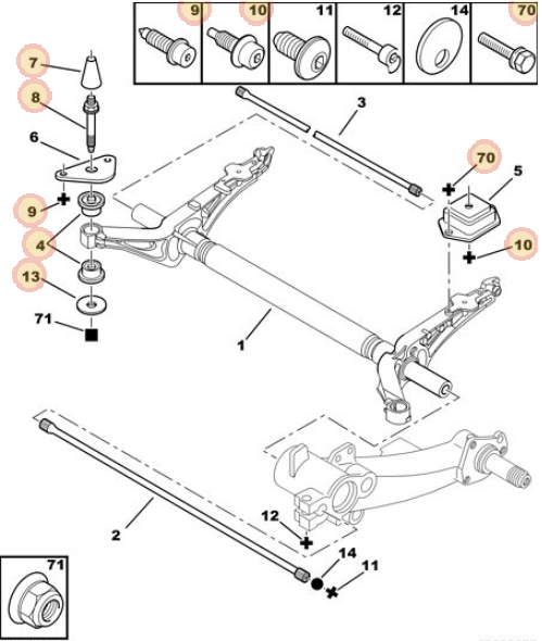

I suspect that I will need parts numbered as follows:GiveMeABreak wrote: 09 Jul 2022, 15:55 If you're talking about the rear suspension crossmember here shown as item (1), then yes they have the same part number for the 600 and 800 vans:
5, 10, 70;
4, 7, 8, 9, 13
Just for starters.

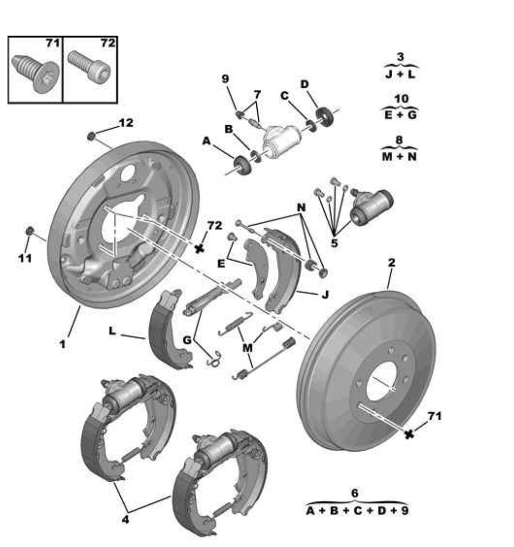

Ordered the refurbished axle and also some of the ancillary parts to include:
Brake pipes and hoses for non-ABS drum brakes
Brake shoes and cylinders
Axle beam mount x2
Now needing the following:
421176, 421276, 424724 (unsure if new part numbers)
Axle beam mount x2

I still need highlighted parts numbered as follows:
10, 70, 4, 7, 8, 9, 13
Having a hard time finding bolts/screws!!

Her you are:
(4) 513147, £56.68
(7) 515135, £2.99
(8) 514424, £6.05
(9) 515324, £3.42
(10) 515325, £4.74
(13) 514607, £6.14
(70) 5132A7, £2.99
As for the rear brake components (421176, 421276, 424724), they are the same part numbers - no changes to date.
